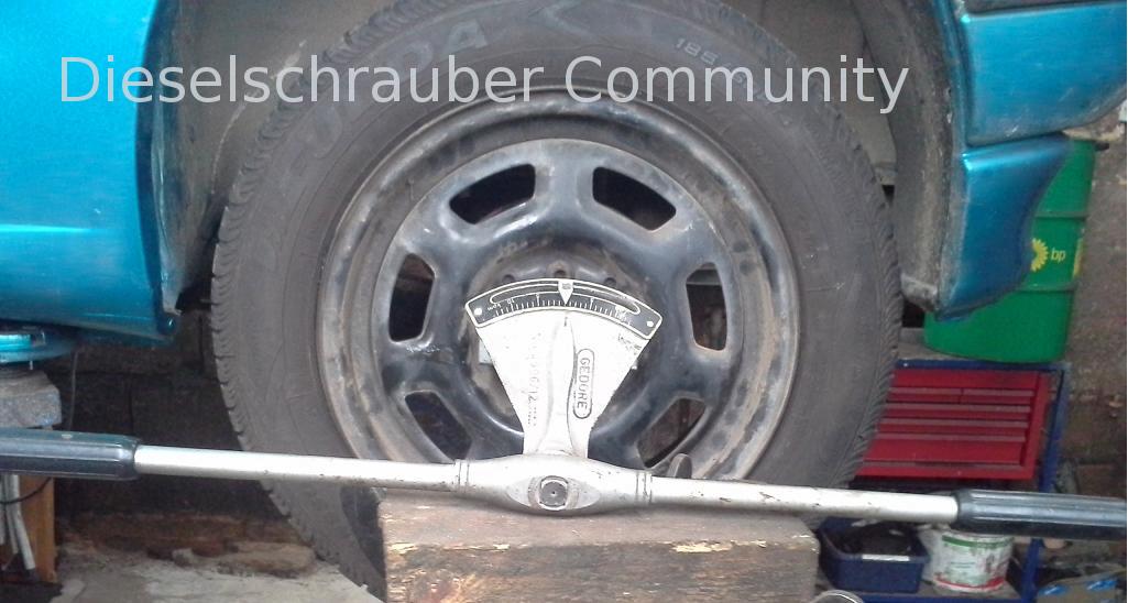

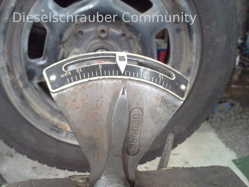

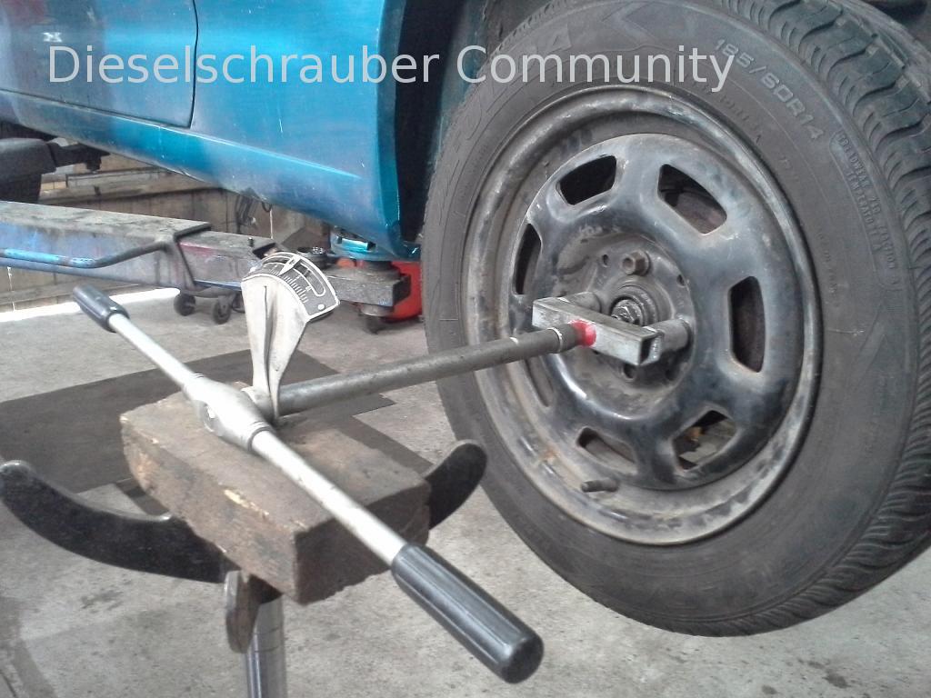

I always perform this test whenever I've worked on the rear brakes, preferably on drum brakes. If it's compatible with my equipment, I'll put it on the rolling road in the workshop. If everything is clean there, the vehicle will then undergo the mandatory technical inspection (TÜV), also on the rolling road.
I am doing this test by myself to see if the effect is uniform or not. If it's not working properly, I can avoid the trip to the workshop and investigate the issue as I am doing now.
Attached are some photos showing my "device."

Okay, but 100 Nm is even pointless for the handbrake.
With drum brakes, the pads still make contact.
Translated on 18-10-2026, 6:20.

Post06-06-2017, 18:29    Subject: Brake Force Limiter (Seat Ibiza 6K) Quote
Herbert wrote:
Nice, but 100 Nm is even pointless for the handbrake.
With drum brakes, the pads still come into contact.
Again: This is a preliminary check solely for me to test the evenness of the braking force from one side to the other on site, so that I can avoid having to go to the workshop with a brake tester if there are any deviations.
So far, all the drum brakes I've built myself have been within the acceptable range of values, and they've been working well enough on the brake tester that the inspector has been able to issue the required sticker without any problems or hesitation.

And then, again, about the torque wrench.
"I no longer have a brake testing machine because it's broken, too old, and spare parts are no longer available. It also can't print a report, and I'm not doing TÜV inspections anymore either."
I've been thinking a lot about the test using the torque wrench.
And what forces are at play during braking.
When testing brakes, for example, when checking the handbrake, the test ends when the wheels slip on the rollers, or when the vehicle is lifted off the rollers.
It has happened to me before, when I was tightening the front wheel hub nut on a car, that the wheel slipped on the garage floor, and someone else had to step on the brake to prevent it from moving further.
If the braking force on the test bench, as I understand it, is around 0.9 kN at the rear, that doesn't necessarily mean you have to apply a torque of 900 Nm using a torque wrench to simulate that. I also don't really have a good idea of how to calculate that.
How did you check the brakes?
Someone is sitting in the driver's seat, pressing the brake pedal, and you are applying torque with the torque wrench.
Did he fully depress the brake pedal, and if so, was the engine running to provide brake assist?
Translated on 18-10-2026, 6:24.
Joined: 06/22/2005
Posts: 4632
Post08-06-2017, 13:37    Subject: Brake Force Limiter (Seat Ibiza 6K) Quote
If the braking force on the test stand, as I know it, is around 0.9 kN at the rear, that doesn't necessarily mean that you have to use a torque wrench with 900 Nm to simulate that. I also don't have a good idea of how to calculate that....
Force x Radius = Torque.
Translated on 18-10-2026, 6:27.
