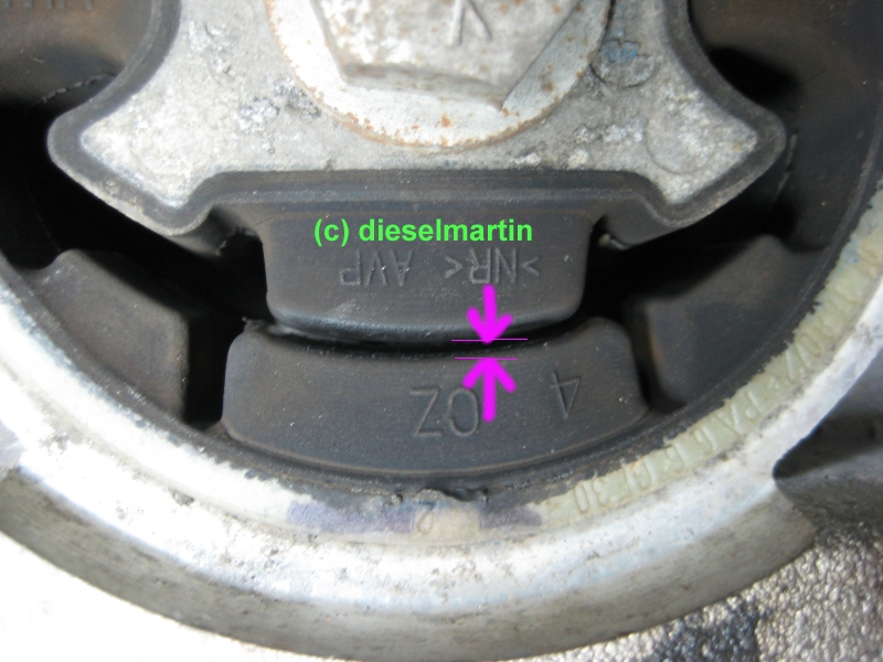

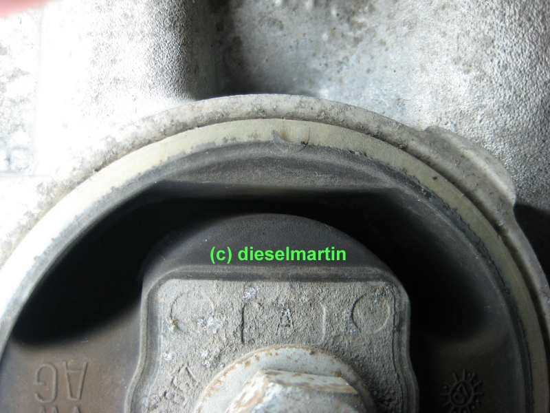

Hi.
Our Golf suddenly makes a loud noise under load at engine speeds below 1400 rpm.
It is silent when unloaded.
My initial suspicion was the torque arm, but it seems to be fine based on the first photos I saw.
At least nothing is broken – but maybe she's not allowed to push forward, because the one from the 3C is bent even further back.
 BLS Train Noise: Sudden Roar / Pendulum Support?
 File size:  47.33 KB
 Viewed:  5430 times
 File size:  132.95 KB
 Viewed:  8060 times

Can someone describe the expected behavior of this storage system?
So, for example, it shouldn't bump into anything directly; the rubber protrusions are just emergency stops, like the buffer pads on shock absorbers... ?

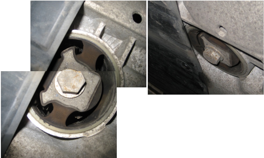

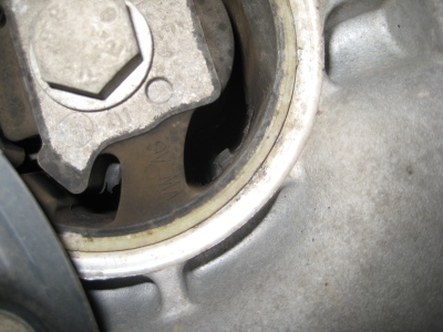

Post24-03-2011, 10:45    Subject: BLS Train Noise: Sudden Roar / Pendulum Support? Quote
Okay,
"Diaper" and "pendulum support" checked.
Could it be that it is supposed to be normally positioned in the front?
I have a small gap there that could be constantly opening and closing due to vibrations from the load, which would allow for a "hammering" sound.
 File size:  204.08 KB
 Viewed:  5889 times
 File size:  239.12 KB
 Viewed:  5135 times
