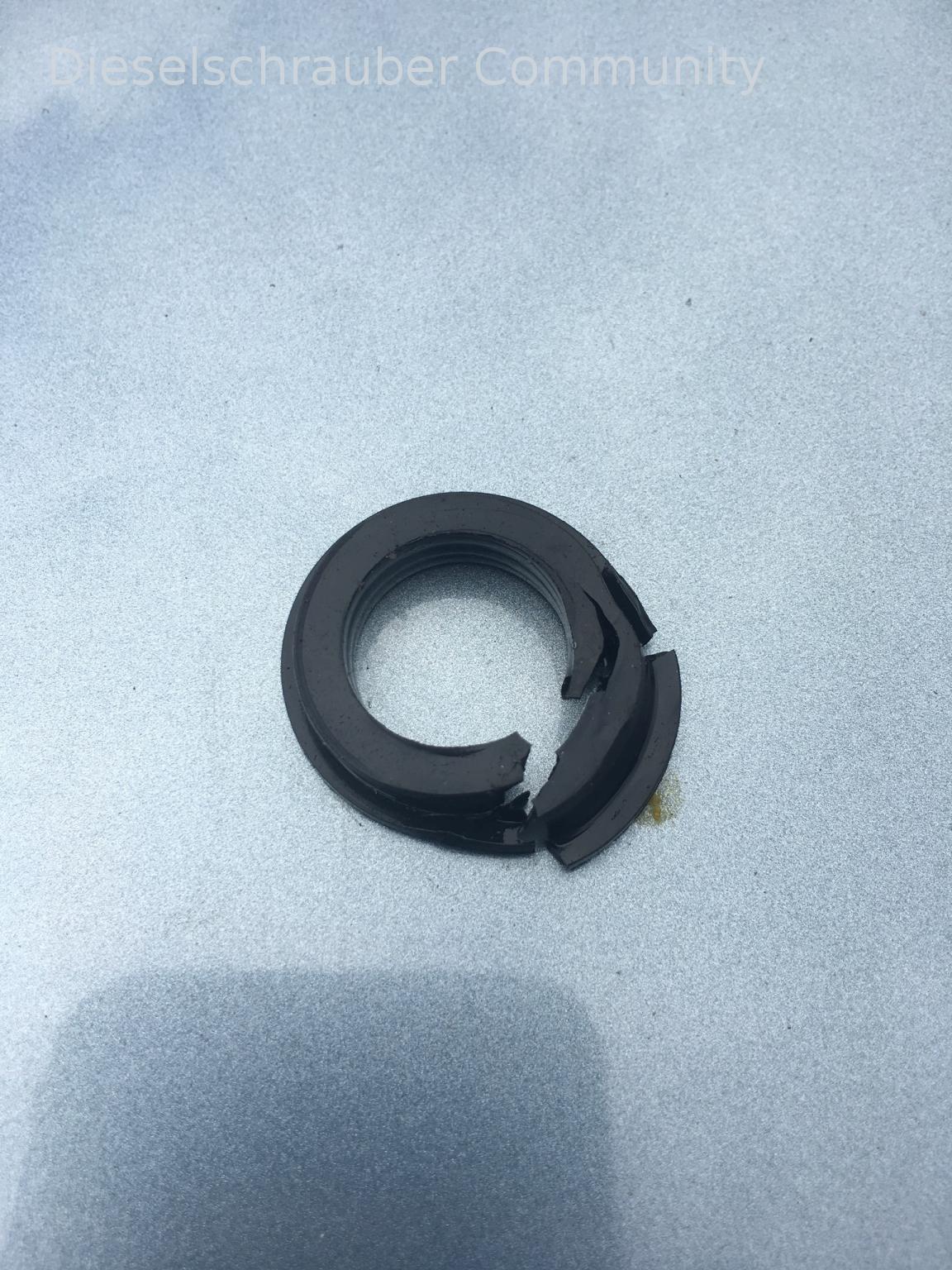

Post17-06-2018, 13:05    Subject: Solution: Find the best solutions now! Quote
Hello!
I just wanted to quickly post the solution to my problem here, so that the next person who encounters it doesn't have to spend ages searching and potentially replace expensive parts.
After replacing the starter, which didn't improve the situation, I replaced the two O-rings on the tandem pump and then had the fuel pressure checked at a VW service center.
7.8 bar at 4000 rpm.
4.2 bar at 1500 rpm.
No change when the return line is blocked.
I then installed a transparent hose on the return line from the tandem pump and the diesel filter.
When the engine was running, the hose was milky white, meaning it was full of air. When the engine was stopped, there was an air bubble approximately 10cm long in the system.
So, I removed the diesel filter, and lo and behold, the internal seal of the diesel filter was completely damaged.
Okay, I quickly drove it around to bleed the diesel filter, reassembled everything - and now there's no more air in the return line.
And the Passat is running again!
Thank you for your help!
 Kaputte Dichtung Dieselfilter
