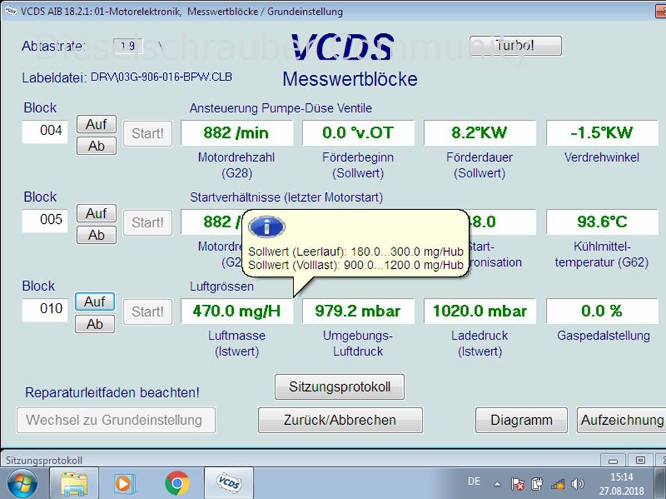

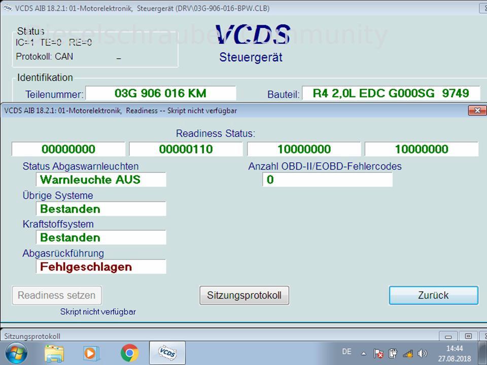

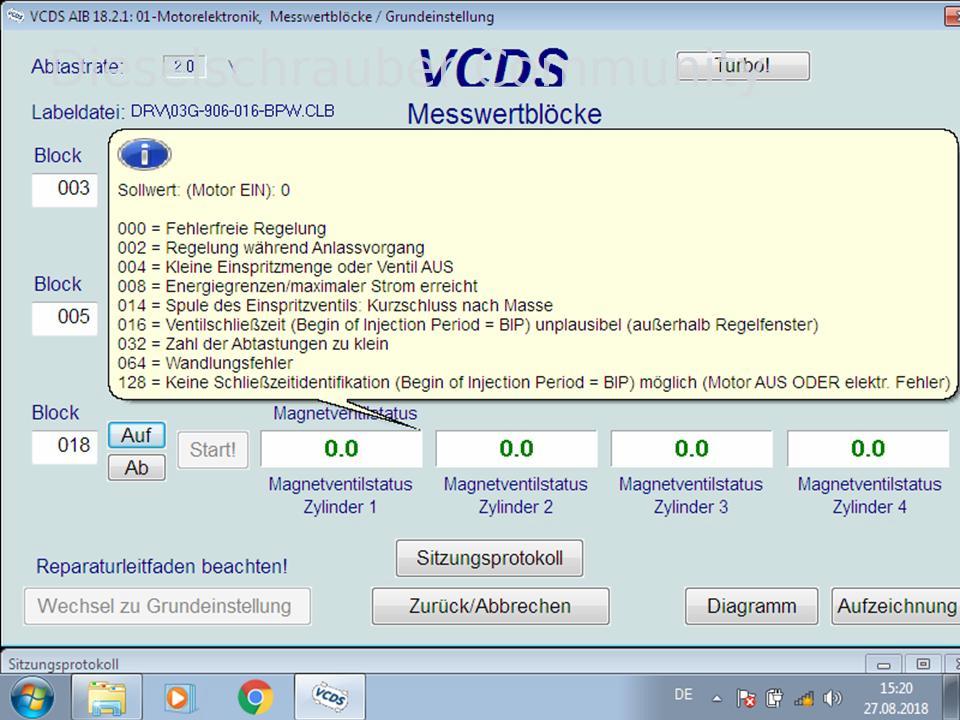

Post28-08-2018, 16:44    Subject: Smoke on Acceleration or Uphill? Quote

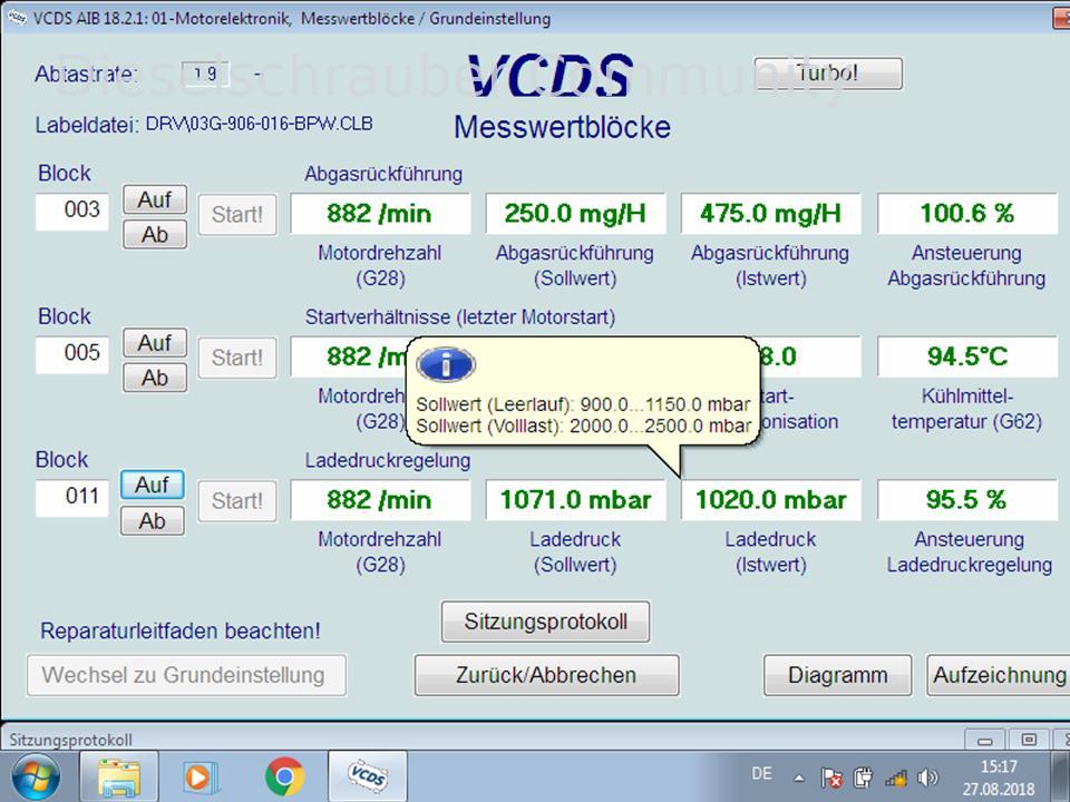

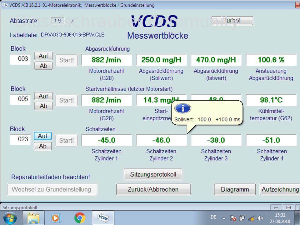

Hi everyone, so the oil was getting into the exhaust system through the turbocharger, for exactly the reasons that you all mentioned (installing a completely rebuilt turbo). That's why I bought and installed a brand new, genuine turbocharger. Now, there's no more oil leaking out, except when I'm driving uphill where a lot of power is needed.
There are opinions that it could be coming from residual oil in the exhaust system, but the measurements show the following:
I have now read out the measurement data blocks.
I took it for another short test drive, under load, starting from a standstill with full power; there was some slight smoke, and it felt like it had a lot of power.
According to the measurement results, there seems to be an issue with the air mass; it appears to be too high at idle, but I'm not entirely sure.
The exhaust gas recirculation occasionally showed normal values as well.
001031 - Potentiometer for exhaust gas recirculation (G212).
P0407 - 000 - Signal too low - Intermittent.
I happened to have a new mass airflow sensor (MAF) lying around, but unfortunately, it's just an aftermarket part from the internet – not an original Bosch part. I'm only using it to see if it makes any difference.
All values are still using the old LMM (Likelihood-Maximization Method).

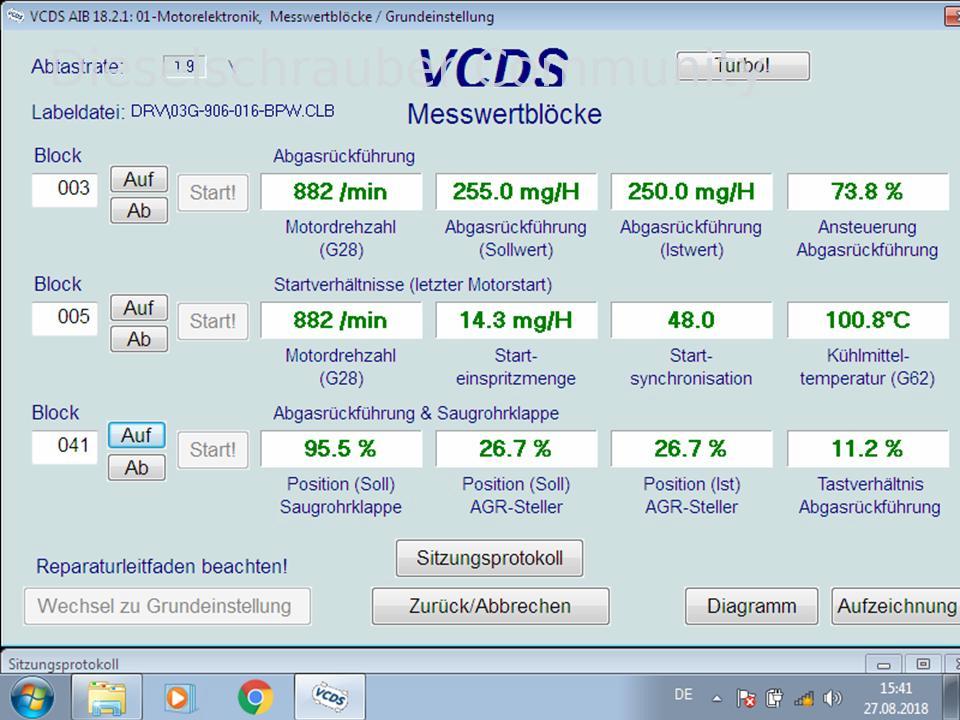

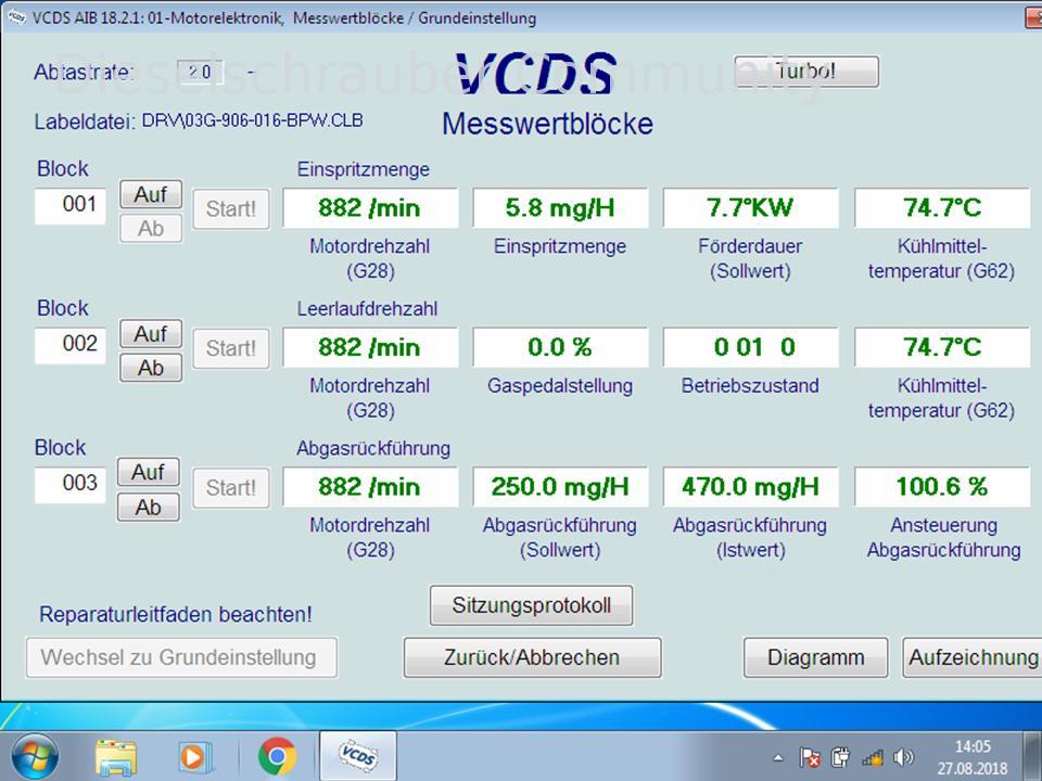

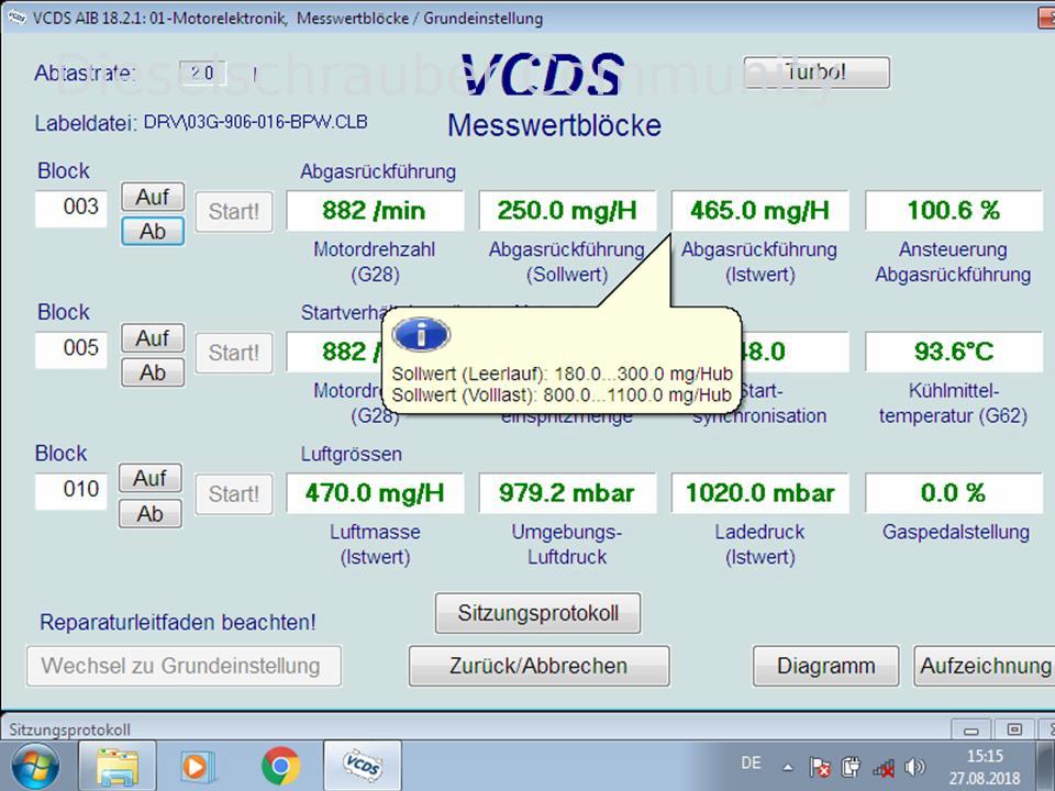

Good morning everyone, does anyone have any ideas why my AGR values are fluctuating so extremely? It could also be related to the smoking issue. ???? icon_smile.gif

Maybe I'm just too stupid.
I see a lot of screenshots there. Anything could be possible. How about we try a real log drive instead? Until then, the answer to all your questions is quite simple from my perspective:
"Possibly" or "Maybe"

Post29-08-2018, 11:23    Subject: Quote
Is the AGR also trained?

Post29-08-2018, 15:46    Subject: Smoke on Acceleration or Uphill? Quote
I removed the EGR valve, cleaned it until it was spotless, and reinstalled it. I then performed the relearn procedure using the five-times ignition off method.
Okay, so it's 5 seconds on, then 40 seconds off, and repeat that sequence 5 times.
The initial values were as expected: Target 250 mg/H - Actual value 250 mg/H, which was great. However, just 15 minutes later, the actual value suddenly jumped to 325 mg/H and couldn't be brought down, even with a basic reset using VCDS.
I'd love to go on a log flume ride, but firstly, my laptop only works when plugged into a power outlet, and secondly, I tend to splash everyone around me until I finally get off the ride.
Unfortunately, things aren't quite how I would like them to be, which is why I'm asking here. icon_rolleyes.gif
Does this mean the EGR valve is defective?
Audianer Audi A4 2.0 TDI 8E B7 BPW Quattro

Post29-08-2018, 18:49    Subject: Quote
I had similar problems with a gasoline engine; it was smoking and smelling bad. I installed a new original equipment (OE) EGR valve, calibrated it using VCDS, and the problem was resolved.

Post29-08-2018, 19:59    Subject: Smoke on Acceleration or Uphill? Quote

Post30-08-2018, 7:20    Subject: Quote
A generic (unbranded) AGR valve was installed there, only a few months old from the previous owner, and attempts to adapt it using VCDS always failed.
