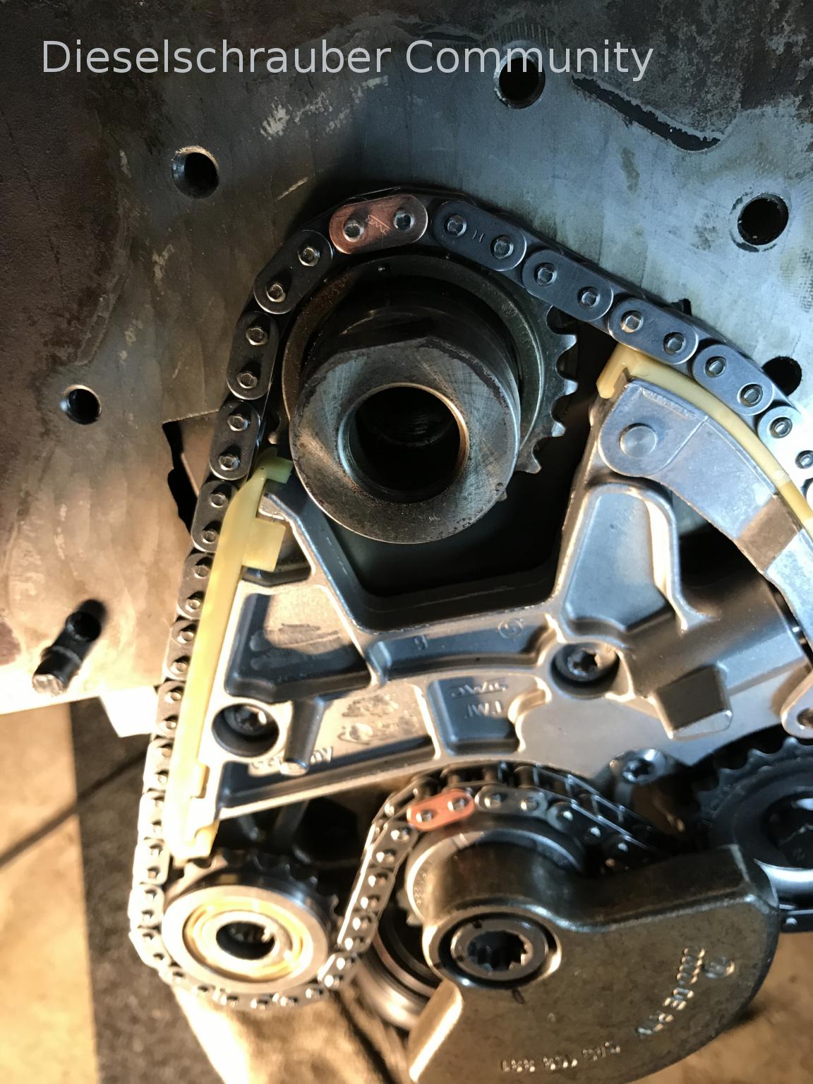

So, the gear in the middle of image 2230 also looks very worn. But you would probably have to replace it anyway because of the missing tooth. Did you notice that the bracket for the hydraulic chain tensioner (2230, top right) is broken?
haithamina
Hi!
Yes, I've already taken care of everything. Everything will be replaced!
Thank you for the information, and I'm sorry for the late reply!

Hello!
I hope you remember that I mentioned before that the oil pressure might be too high, especially considering how the chain tensioner looks.
I'm mentioning this only because there were similar issues with the VR6 engines in the past. Of course, those involved chains of a completely different scale; they didn't break.
However, in that process, the clamping rails can get worn down, and the resulting shavings could potentially clog the oil pump's intake screen, which would be the worst-case scenario.

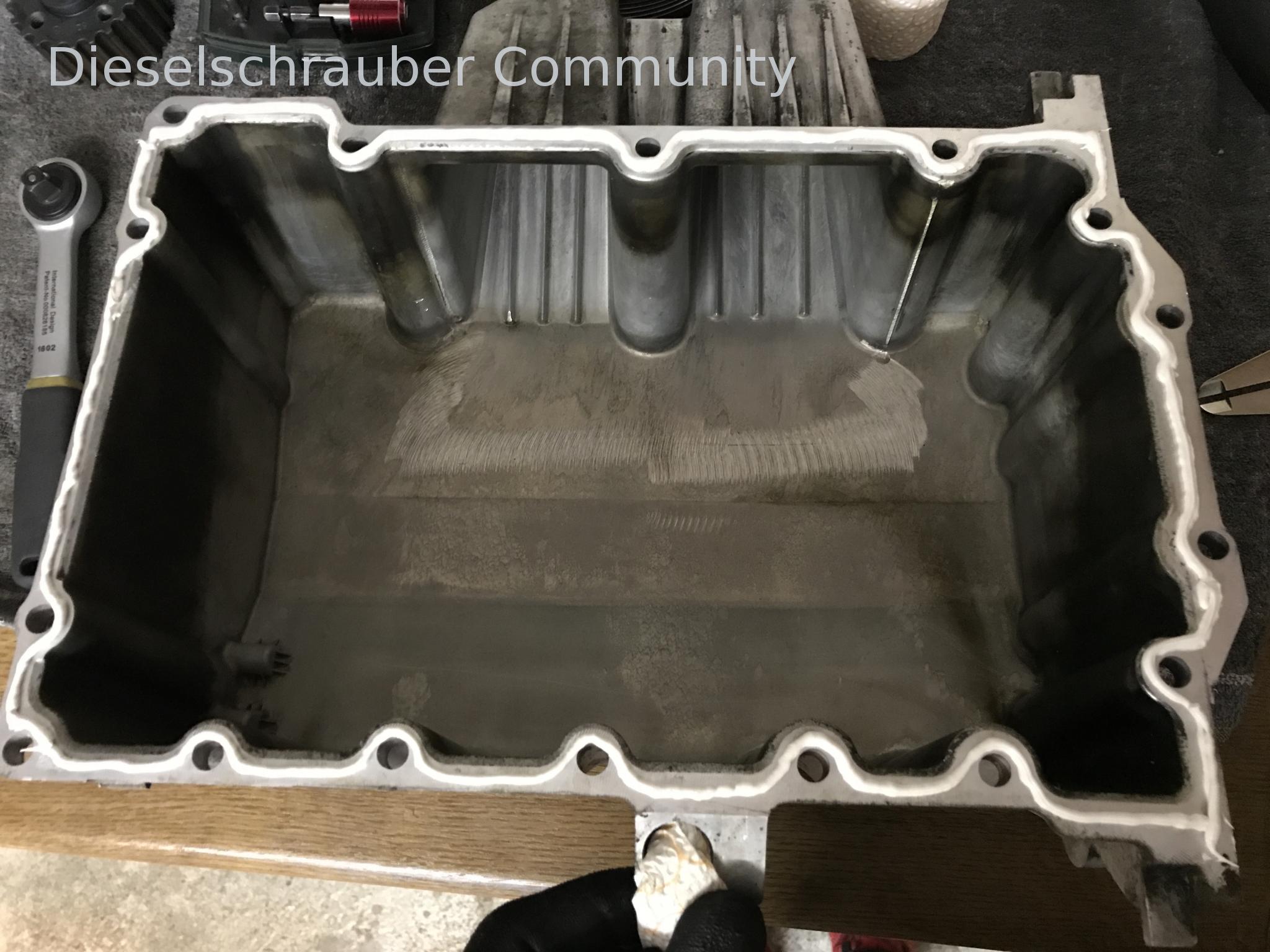

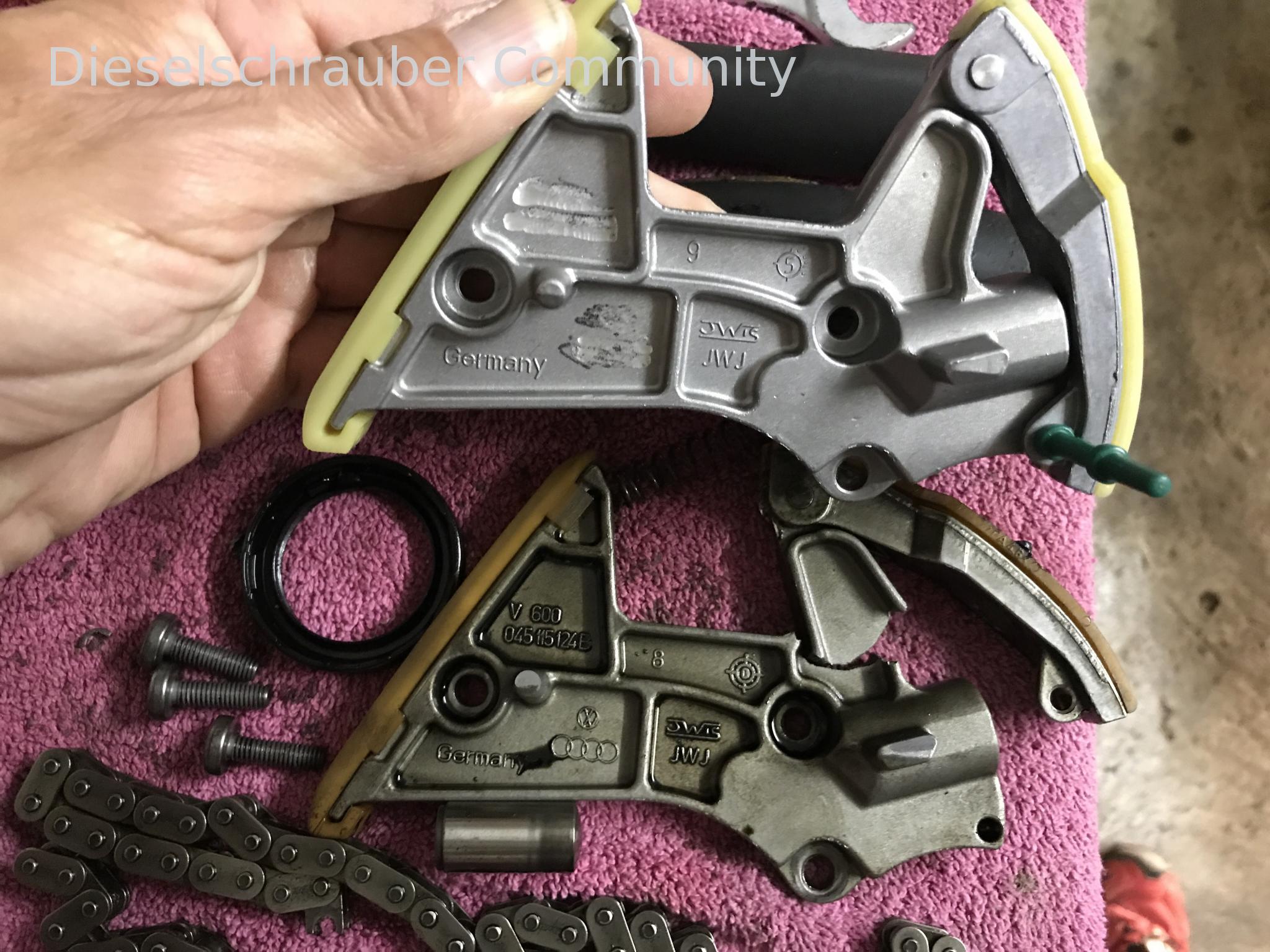

Hello everyone,
I've now driven the Polo for 1000 kilometers!
The turbocharger seems to have survived, hopefully all the other parts as well!
Thank you all so much for your help – it really made things easier for me!
And now, here are a few more photos for those who are interested:
 Wenn man Febi kauft, bekommt man "VW-Teile"! :-)
 File size:  2.21 MB
 Viewed:  499 times
 File size:  2.4 MB
 Viewed:  473 times
 File size:  2.35 MB
 Viewed:  551 times
Translated on 26-07-2026, 16:24.
