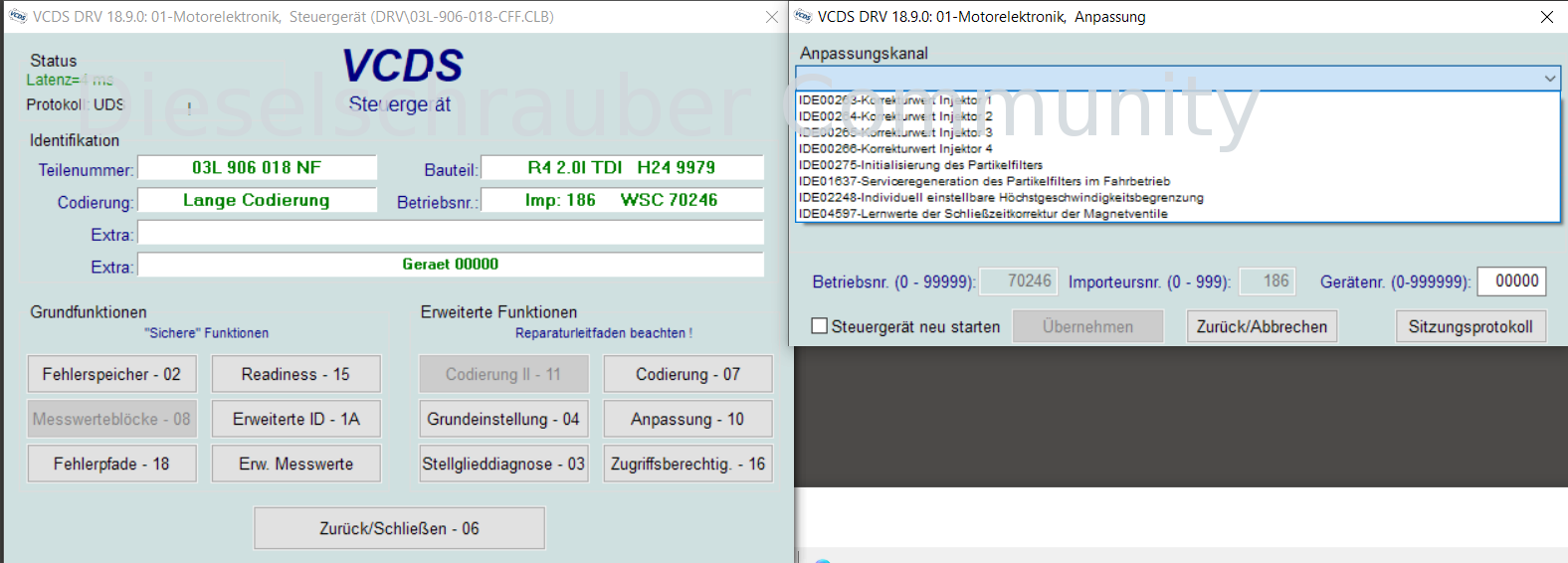

Please check the adaptation channels in your engine control unit.

Unfortunately, I couldn't find anything similar (see Screenshot).

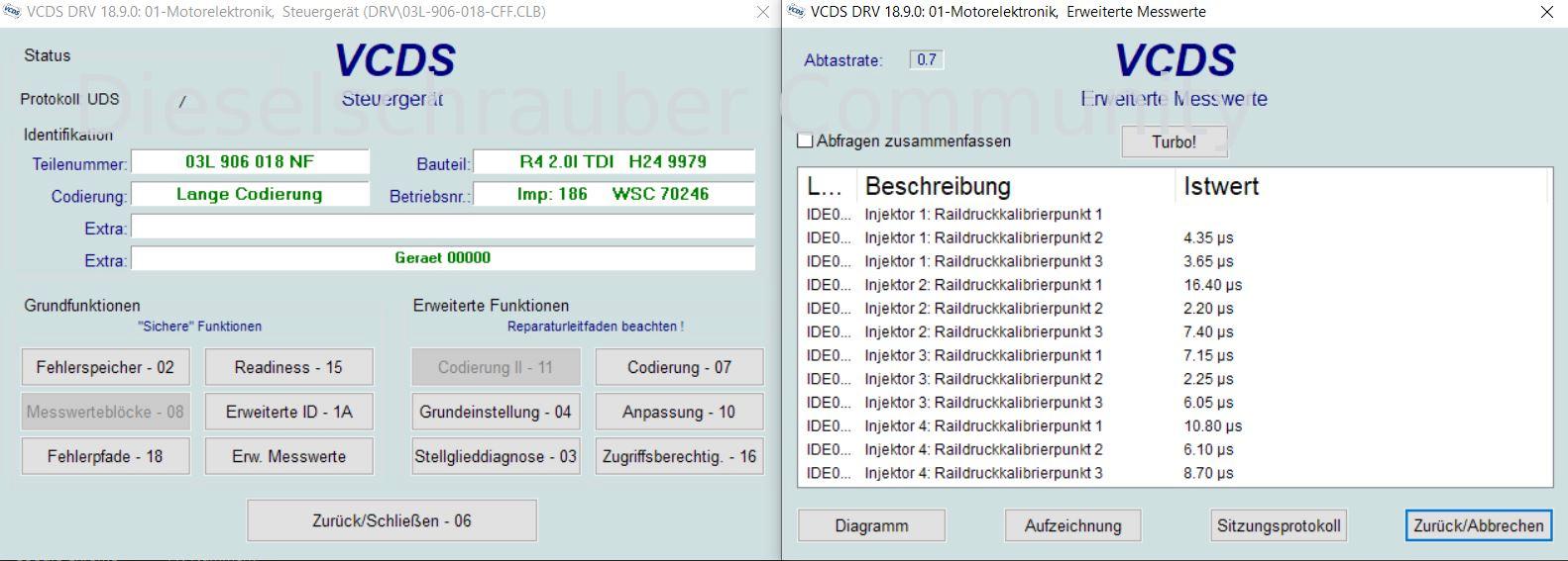

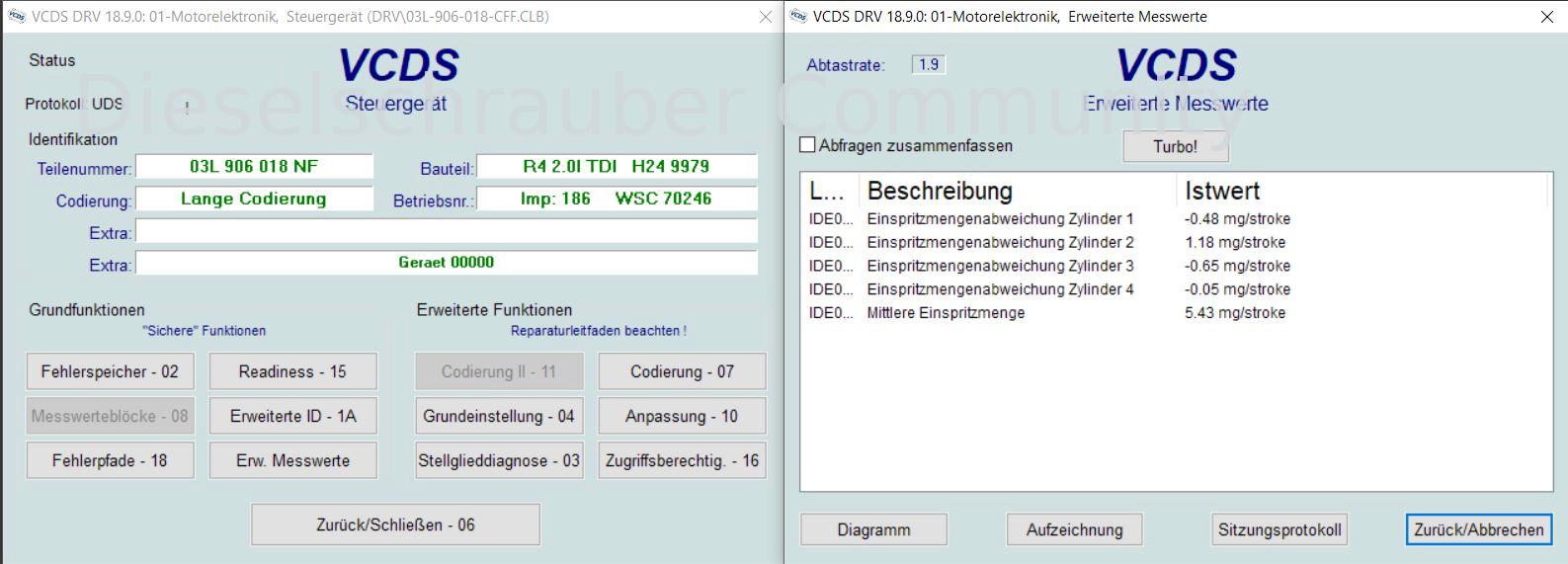

I have some screenshots regarding the quantity discrepancy and closing time correction. Cylinder 2 seems to be behaving differently.
