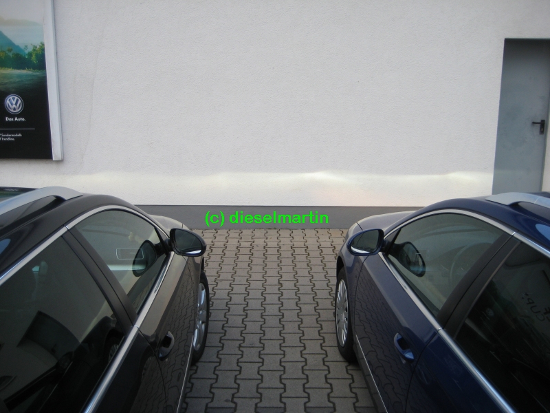

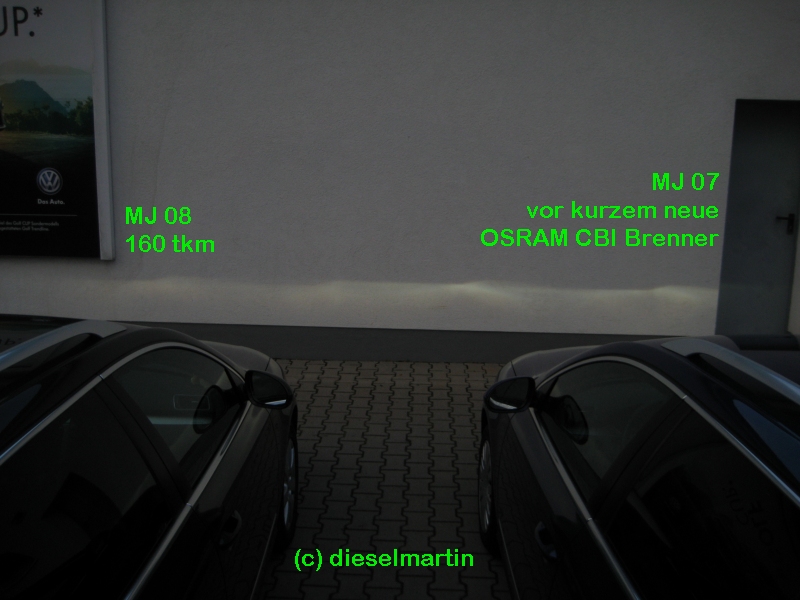

Hi.
I had already upgraded to the "Cool Blue" version.
I don't think it's blue, especially when compared to an E-Class, but it has a nice, bright light.
Osram D1S 66144CBI Xenarc Cool Blue Intense.
 Vergleich Xenonbrenner Tag
 File size:  257.94 KB
 Viewed:  4250 times
 Vergleich Xenonbrenner Nacht
 File size:  201.36 KB
 Viewed:  6028 times

Post14-09-2014, 9:56    Subject: Xenon bulb buying recommendations Quote
Steffen W wrote:
... with time ...
How long was the time?
My burners have been installed for... well, roughly... about a year now.
I was able to make a comparison with the E-Class (the last one with Xenon, NOT LED icon_wink.gif) on Thursday.
