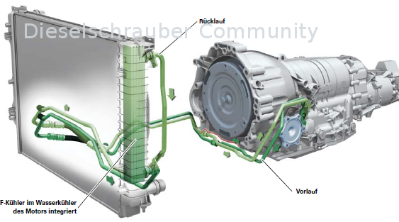

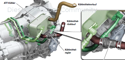

guste100 wrote:
Are you both absolutely sure that there are no other thermostats in the small cooling water loop of the gearbox? "This was at least the case with the Passat 3C with DSG, and it seems quite plausible to me..."
Yes, I am 100% sure. The 09L gearbox only has an external water-oil heat exchanger for the gearbox in the Audi A8 and Q7.
It shares the water cycle with the motor and an external thermostat.
In all other models, it is as described in the previous post, the gearbox oil cooler is integrated into the water cooler.
Greetings, Mpire
Yes, Mpire is definitely right! The A8 and the Tuareg, both with the same engine, have different oil coolers and a small inline thermostat. Not an All-Road!
Greetings
Bo
