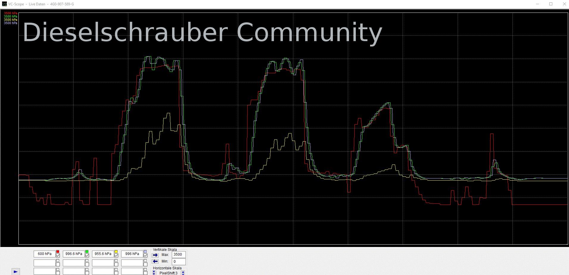

Post11-10-2020, 20:30    Subject: Boost pressure control exceeded 3.0 bar, P0299 code / rough running Quote
Thank you. I did a pressure test to make sure everything is sealed, although I couldn't imagine it leaking because the error only occurs during the first 3 minutes and only when the system is completely cold; after that, the error never appears.
The diagram in VCDS showing the target vs. actual boost pressure looked okay to me...

Post12-10-2020, 17:49    Subject: Boost pressure control exceeded 3.0 bar, P0299 code / rough running Quote
Please upload the raw VCDS log files; the image is not very informative. I hope you're familiar with KDataScope...
If the error only occurs when the engine is cold: Is the software in the engine control unit original, with no chip tuning or power box?
