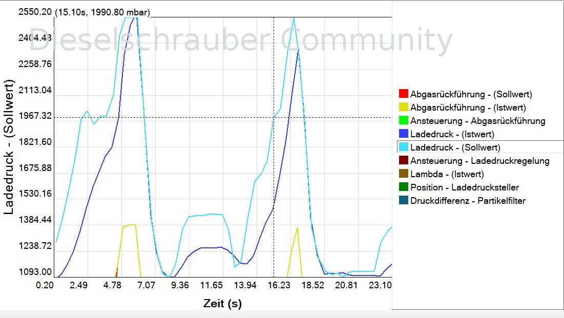

I've already checked the pre-pump, and everything seems to be fine on that side (it only needs 0.5 bar of pressure for the diesel to reach the tandem pump without air bubbles). And I can live with the fuel level sensor...
"But you're right, it could definitely run better. The other day, I did a logging session without any regeneration occurring. I noticed that the actual boost pressure is always lagging behind the target boost pressure by about 0.2 to 0.5 bar."
My guess is that when it goes into regeneration mode and everything around the charger gets hot.
- Either the loader itself is malfunctioning, or it's a problem with the VTG (Variable Transponder Generator).
- A vacuum hose.
- or the DPF creates too much back pressure.
Unfortunately, I'm still waiting for the system to regenerate so I can start logging data.

11-04-2021, 21:15 Subject: A4 2.0 TDI Germany: Runs poorly during regeneration + fuel level sensor issue |
Quote |
Hi.
Quote: | - Either the loader itself is malfunctioning, or it's a problem with the VTG.
- A vacuum hose.
- or the DPF generates too much back pressure | .
You are correct. Please also check during normal operation whether the target pressure for the turbocharger is being reached. If it's difficult to achieve, additionally inspect the intercooler system for leaks, in addition to the points you mentioned.
Since a higher boost pressure is used during regeneration in partial load conditions, these problems become more noticeable, which could explain why the car performs particularly poorly during regeneration.
