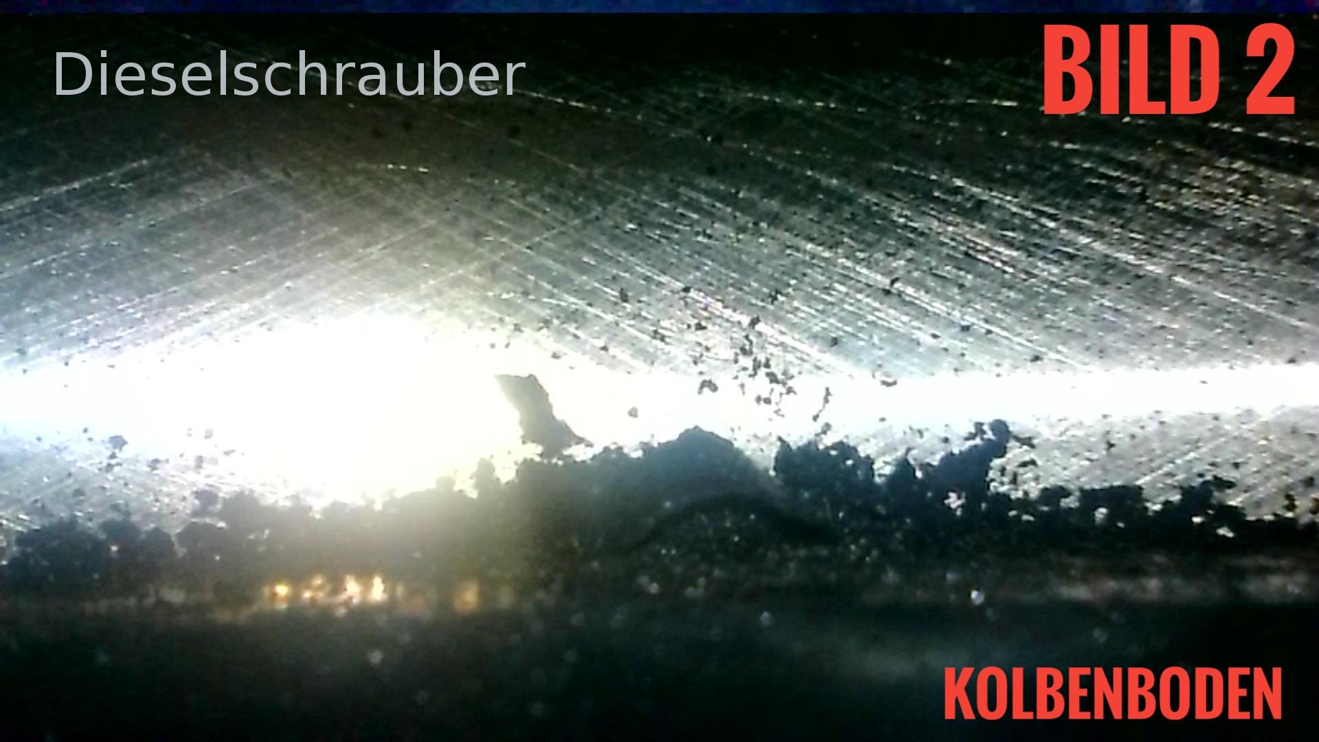

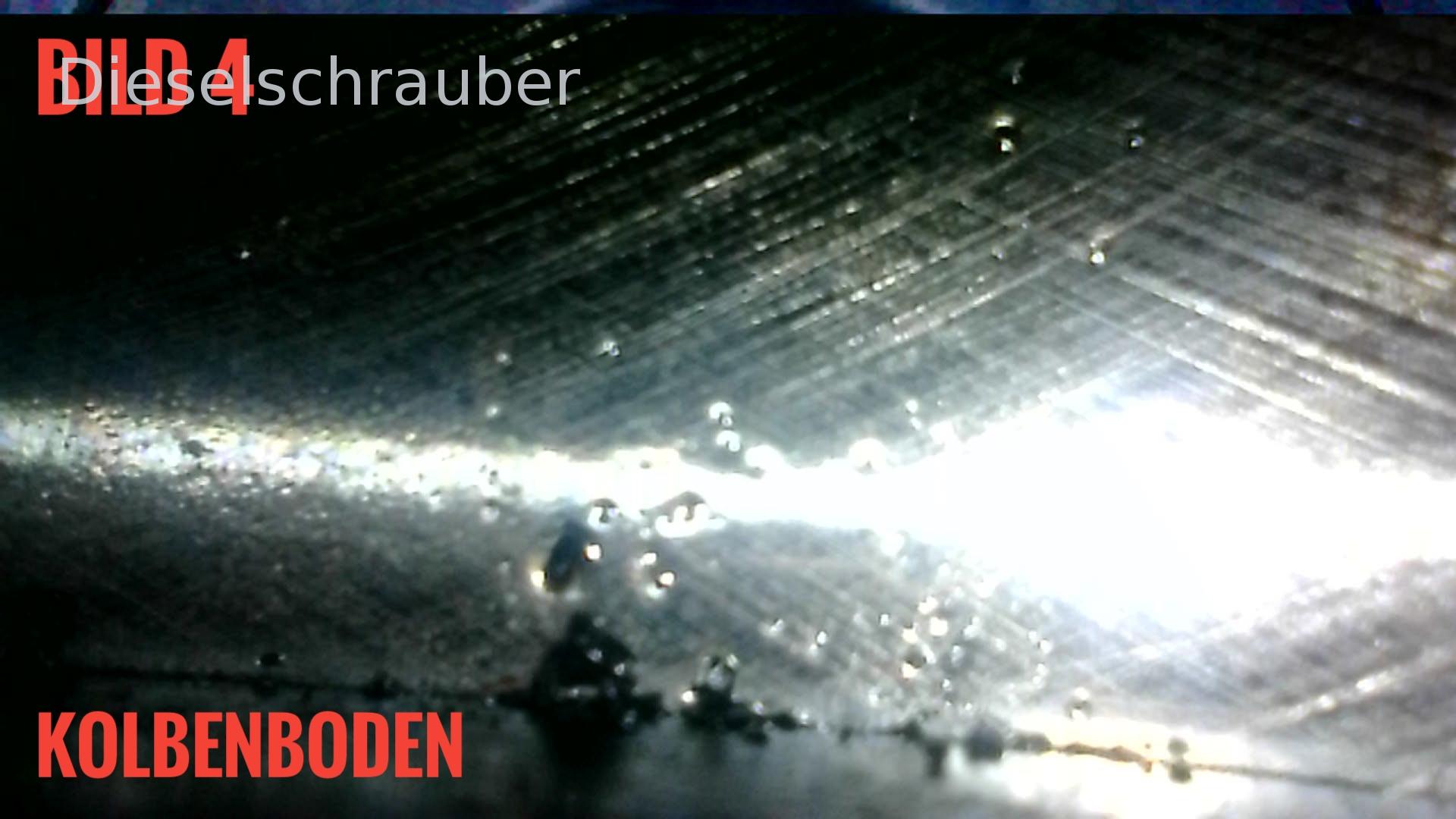

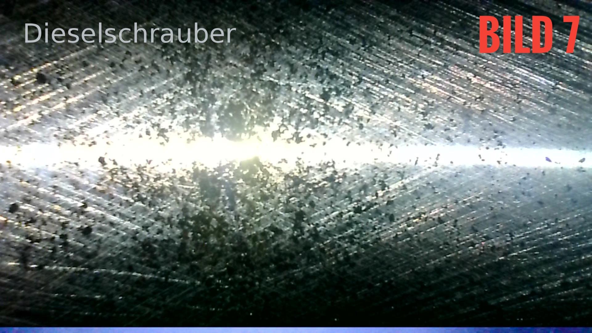

Hello, I removed my injectors yesterday to have them checked, as well as...
I looked into the combustion chamber with my endoscope camera.
Now I have 3 questions that remain unanswered.

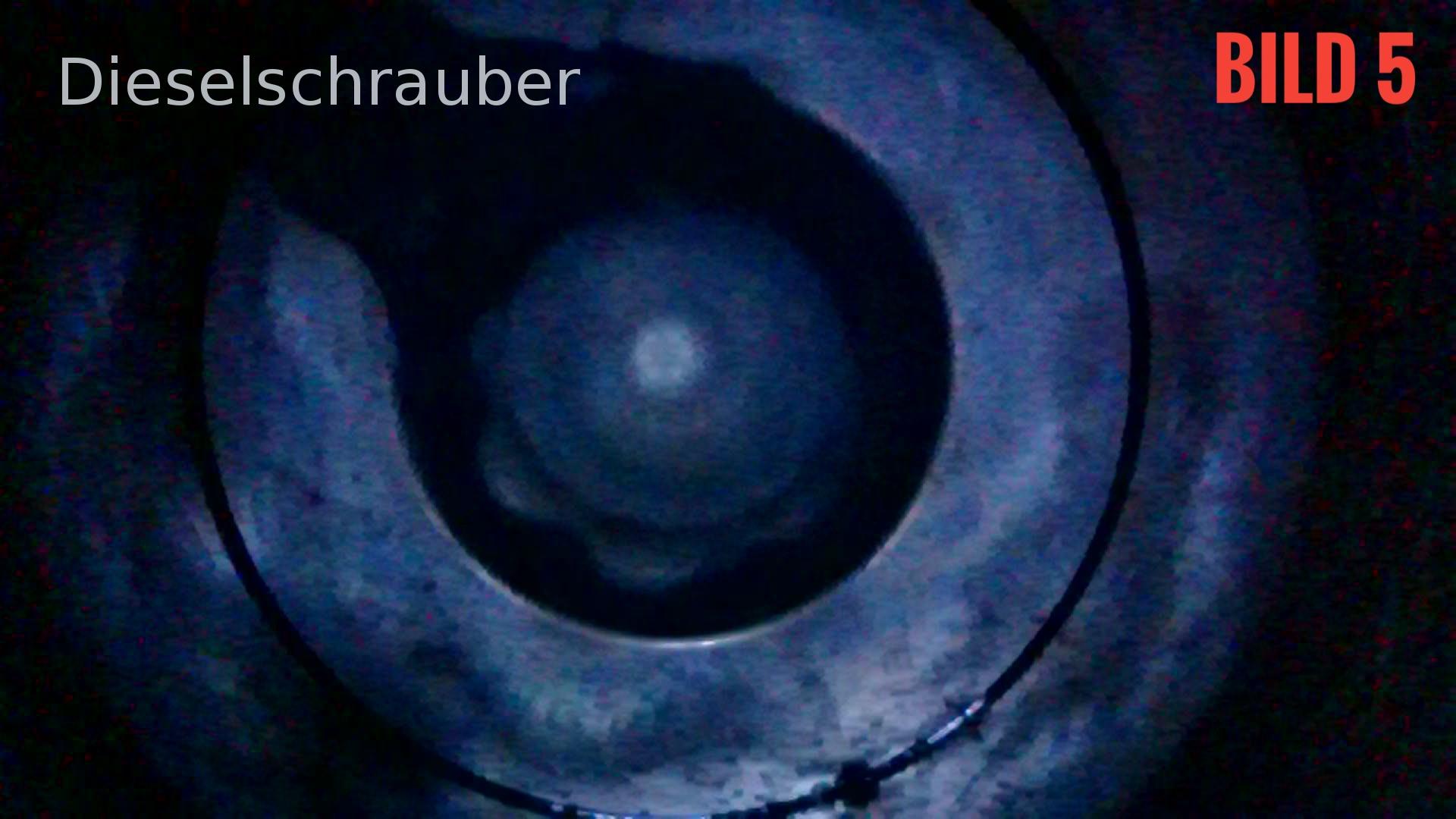

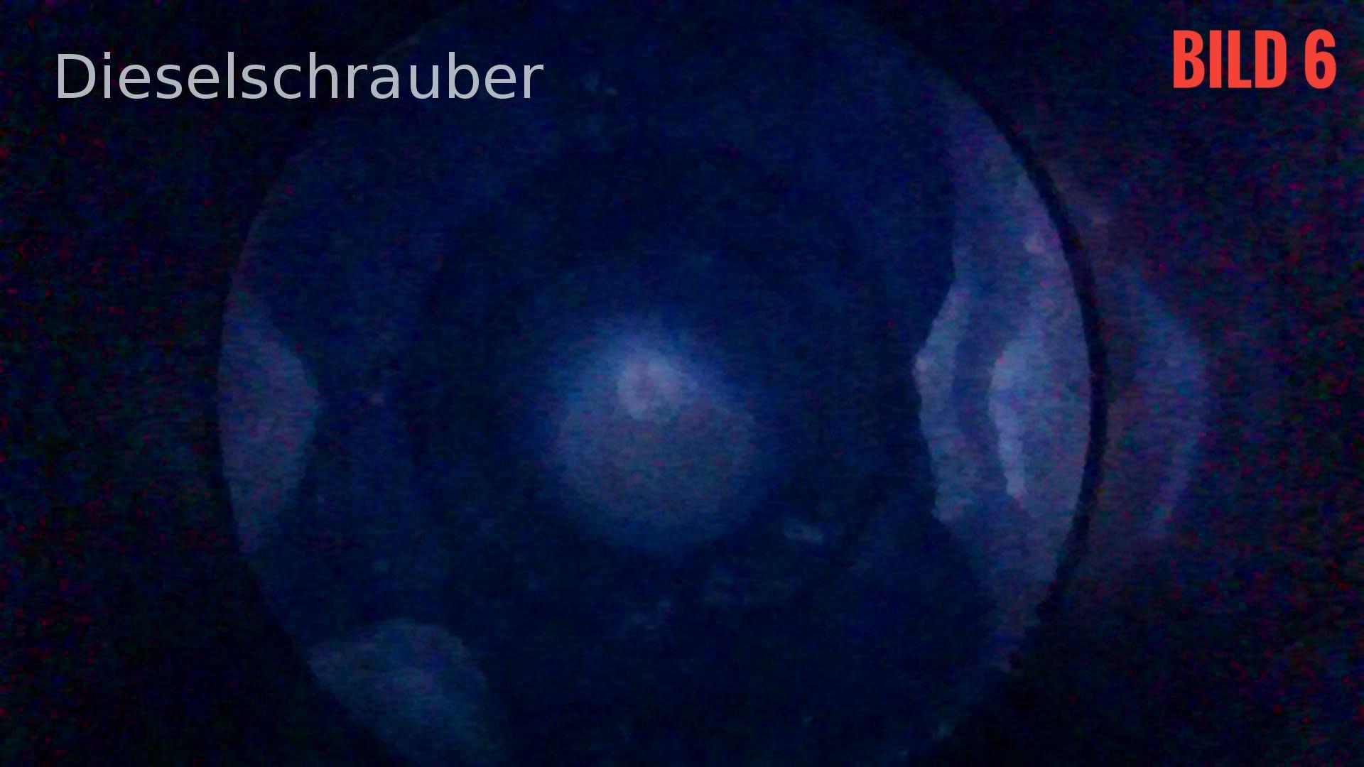

Why do some pistons on the top side have no carbon deposits? (Image 5, 6)

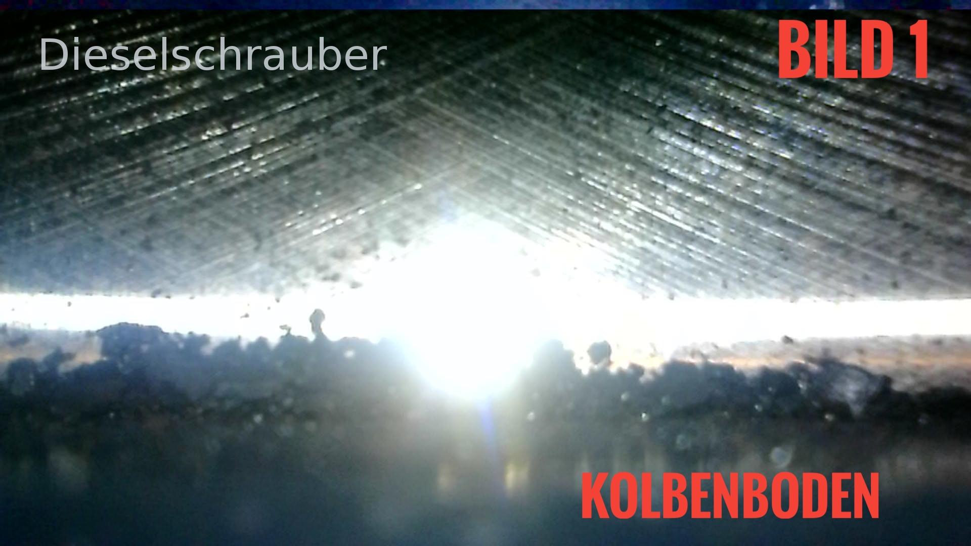

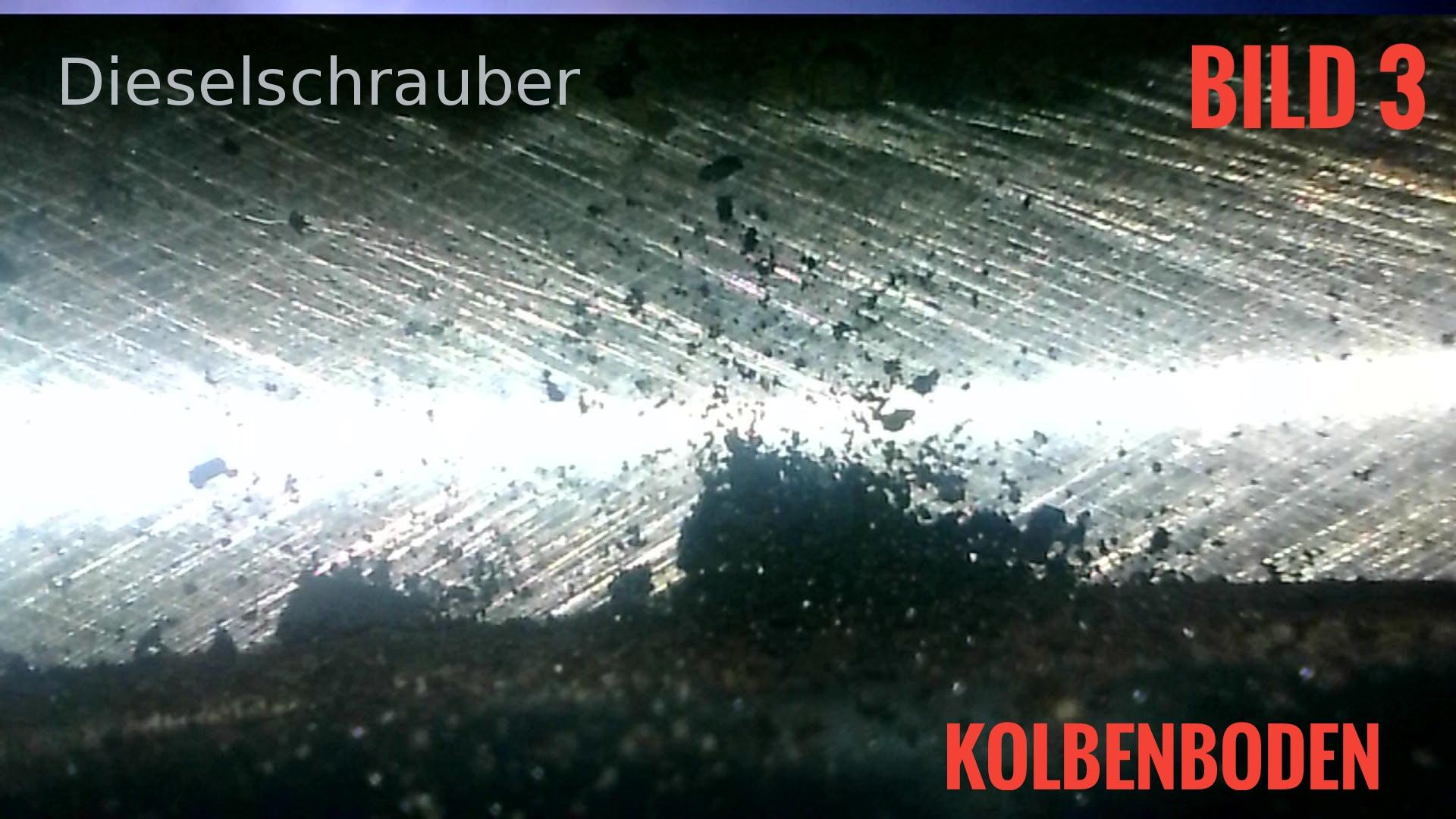

2) Are the carbon deposits on the piston crown and cylinder wall normal, or are they harmful? (Images 1, 2, 3, 4, 7)

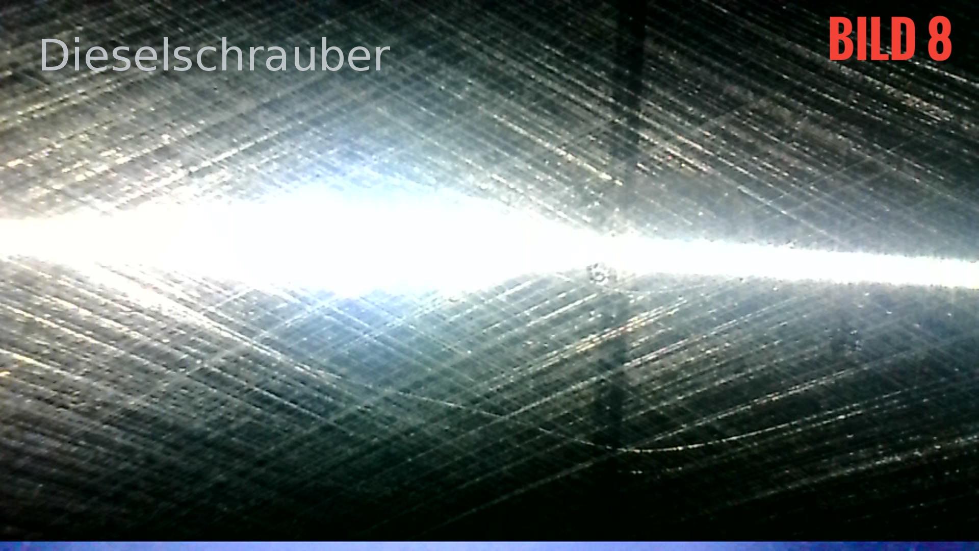

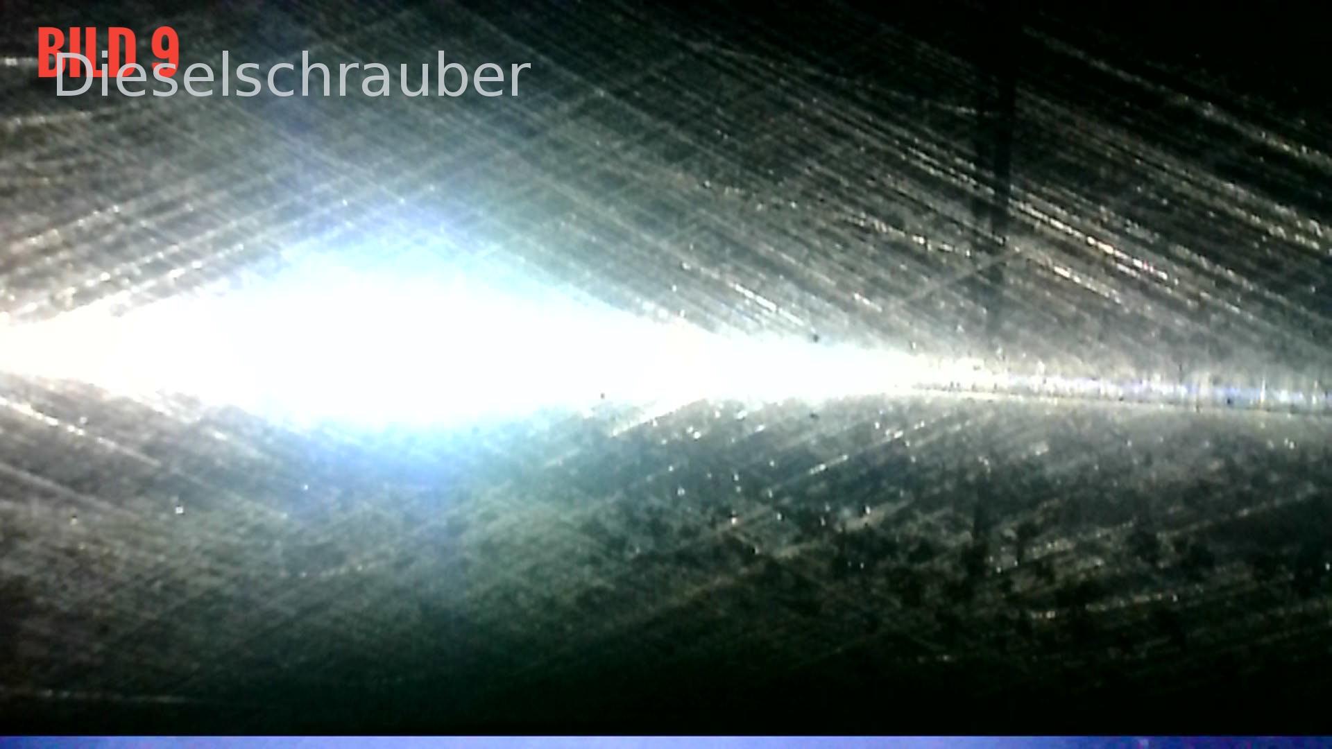

3) What do you say about the scratch marks on the cylinder wall? (See images 8 and 9).
The Audi was manufactured in 2014 and currently has almost 89,000 kilometers (approximately 55,000 miles) on the odometer.
I hope you can help me; thank you in advance.

Soot or lack thereof can be caused by differently functioning injectors...
The marks could be caused by moisture in the cylinder after a period of inactivity.
What are your oil change intervals?
Do you use branded or generic diesel fuel?
Translated on 15-07-2026, 14:19.

It's impossible to avoid marks inside the cylinder. The best approach is to run the engine thoroughly hot before storing it for the winter and then turning it off, avoiding any further use in between.
When my father used to winterize the Claas Columbus combine harvester, he would insert oily rags into the exhaust pipe and the air filter connection.
I would now remove the glow plugs, clean them, and reinstall them with ceramic paste on the threads, possibly replacing them if necessary. Be sure to observe the specified torque when tightening.
Translated on 15-07-2026, 14:23.

So, you're saying that these small deposits of soot, as seen in images 1, 2, 3, and 4, don't pose a significant problem?

It is important to carefully clean the area where the burner nozzles are located.
In my opinion, soot from diesel engines is normal.
Translated on 15-07-2026, 14:25.
