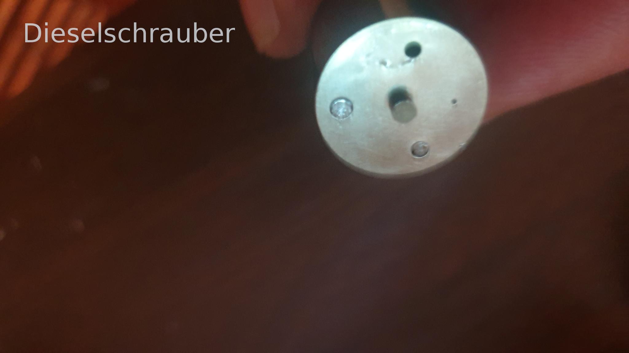

Post12-08-2022, 15:32    Subject: Quote
Great!
Here's a picture of the perpetrators.
 File size:  2.29 MB
 Viewed:  638 times
Translated on 31-07-2026, 16:18.

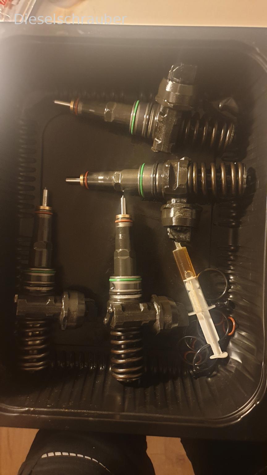

Post11-10-2022, 20:06    Subject: Quote
"Everything is working perfectly, the right parts are installed, and the car is running wonderfully."
 File size:  2.93 MB
 Viewed:  296 times
Translated on 31-07-2026, 16:25.
