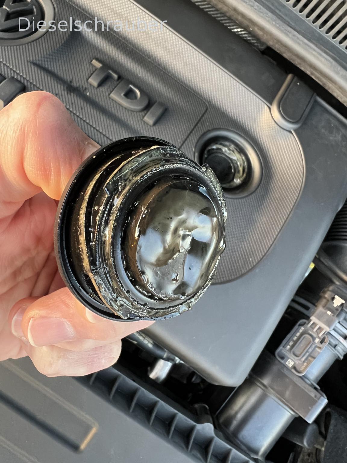

Hello everyone,
If anyone is available to share their expert opinion with me:
I'm currently looking at a Polo car, manufactured in 2015, with 145,000 kilometers on the odometer.
When idling, it sounds really bad; the flywheel is defective and will be replaced soon.
My question is: Could a faulty flywheel have caused permanent damage to the transmission?
Also: Distinct light brown traces of lubricant are visible on the oil filler neck, as can be seen in the photo. Is this a warning sign?

Post08-03-2024, 18:37    Subject: Used Car Buying: How VCDS Can Help You Quote
If it's almost free and you can repair everything yourself, then go for it...
The sour cream might be from a local source; everything else will become apparent when disassembled.

Post08-03-2024, 19:27    Subject: Used Car Buying: How VCDS Can Help You Quote
My question about this! Could a defective dual-mass flywheel have caused permanent damage to the transmission?
Yes, if the failing DMF has damaged the transmission housing. This can lead to complete failure depending on the extent of the damage.
