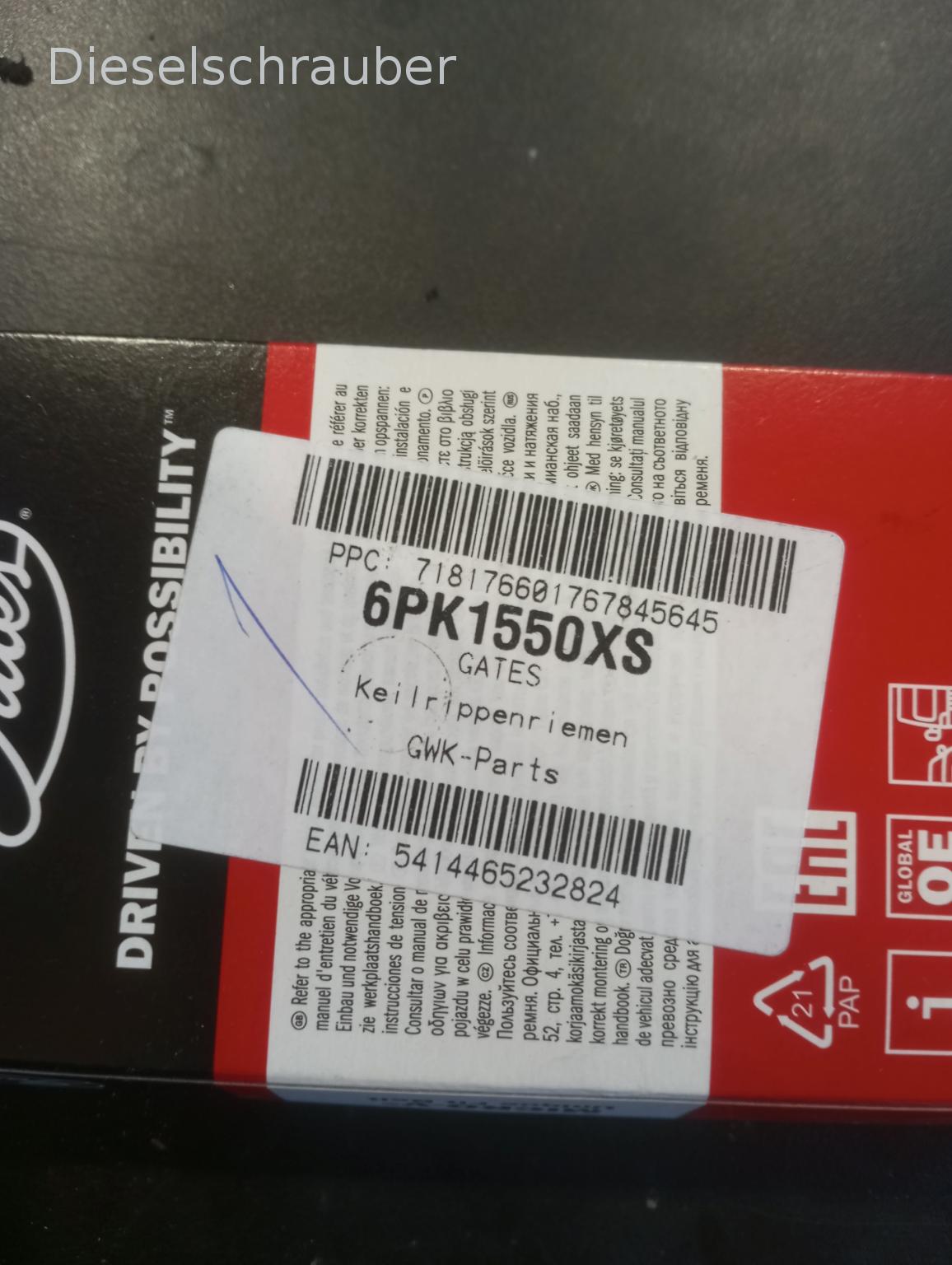

The belt has now settled in quite well. The spray didn't help at all. Unfortunately, I had to drive about 2000 km with a lot of squeaking. Surprisingly, it doesn't seem to be very hard on the belt. It looked remarkably good when I took it apart, and I was actually worried that it might be falling apart.
Today, I removed the old belt and checked everything. No abnormalities detected, everything is running smoothly, the tensioner is working properly, and the pulley is also fine.
My current suspicion is that the drive sprocket on the crank shaft is worn out. Unfortunately, I don't have a new one on hand, so I reassembled everything today using a belt that's 5mm shorter, which will require the tensioner to apply more tension.
So, the length is 1550 mm instead of 1555 mm. It would be great if that thing would just shut up now.
