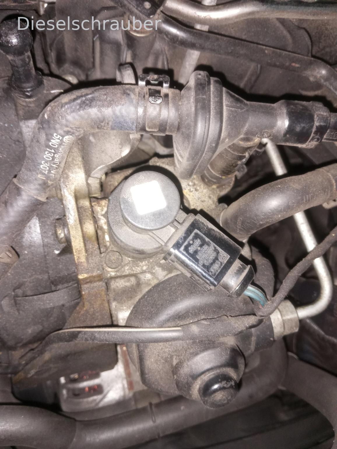

- Mass flow control valve N290 is defective.

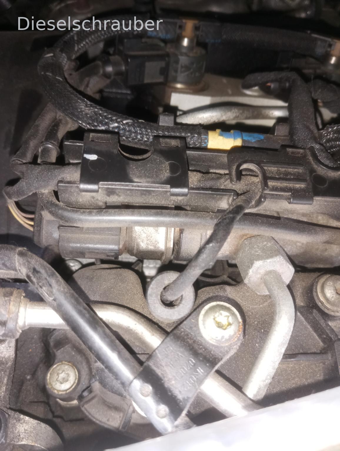

- Pressure regulating valve N276 is defective.

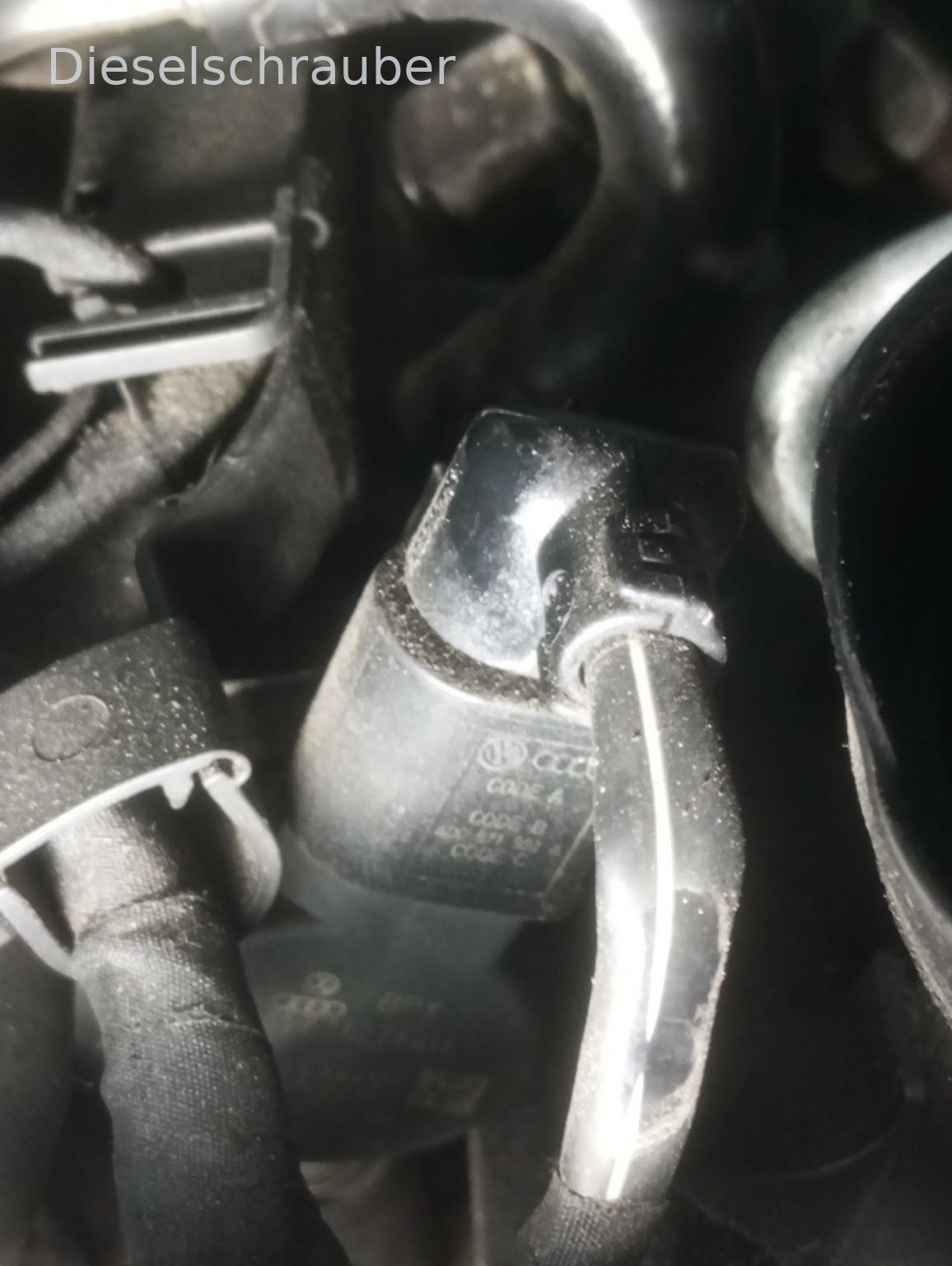

- The G247 rail pressure sensor is providing incorrect readings.

- Replace the N290 quantity control valve.
- Replace the rail pressure sensor (G247).
