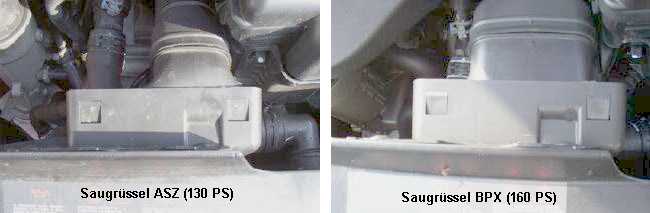

Post16-07-2004, 14:21    Subject: Quote
Hello again.
I borrowed two pictures of suction cups from the Ibiza forum (@Monchi: I hope you're not upset).
-> once, the well-known ASZ engine in the Ibiza 6L (my Polo has the same parts).
-> Once, I had the new 1.9-liter engine with 160 horsepower in an Ibiza Cupra 6L.
When I look at this and consider that normal TDIs, due to the bottleneck called the intake manifold, already experience about 50 mbar of "air restriction" at maximum pressure, but a large intake diameter apparently is also feasible, then I wonder why not allow all TDIs to have an unrestricted intake, like the Ibiza Cupra?
Okay, I don't know exactly how much larger his intake opening is compared to the ASZ.
But for just ~0.2 bar, which is 15% more boost pressure than the standard turbocharger, it already looks quite impressive, doesn't it?
The 160 model actually reaches its peak power at 3,750 rpm, if I recall correctly.

I think I read somewhere that the narrow suction nozzle also serves as a noise reduction measure.
1. Less noise escapes from small openings compared to large ones.
The thinner the air, the lower the sound energy density.
3. The thinner the nozzle, the greater the flow velocity must be to transport the same volume per unit of time. The sound waves travel against the flow, which further minimizes the noise.
These effects will likely be carefully weighed against the negative effects of the vacuum in the air filter housing, and this will lead to the chosen diameters...
Greetings.
Eike.
Translated on 30-09-2026, 7:57.

Post16-07-2004, 22:06    Subject: Quote
eike wrote:
I think I read somewhere that the narrow suction nozzle is also a noise reduction measure.
. . .These effects will likely be carefully weighed against the negative effects of the vacuum in the air filter housing, and this leads to the chosen diameters...
It might be true... in that case, the 6L Cupra would have to have a kind of "license to consume more fuel" icon_cool.gif.
But I can't quite imagine him sounding like a stereotypical "proll."
I once drove my car with the air intake system completely disconnected from the suction snorkel (using a hot air intake), and I practically didn't hear any difference.
With gasoline engines, I can understand it more easily, like the hissing sound coming from the throttle valve shaft, etc.
Or did the Ings simply adopt diesel technology without thinking and without any real need icon_evil.gif icon_question.gif?

Post19-07-2004, 9:28    Subject: Quote
Hi Ulf,
Did you watch that AFN broadcast about the Russell case back then?
If it's as thin as the one from the 1Z, you shouldn't be surprised about the intake manifold vacuum.
Why do the new engines draw air from the front again, instead of from the fender like before?
Translated on 30-09-2026, 8:00.
Joined: 04/13/2002
Posts: 11058
Location: Saarland
Post19-07-2004, 10:32    Subject: Quote
dieselmartin wrote:
Did you watch that Russell interview from AFN back then???
Yes, just looking at it gives you a feeling of suffocation... I think the intake diameter is around 10 cm².
Why are the new engines drawing air from the front again, and not anymore from the fender
Is that the case with all newer engines?
-> Perhaps to keep the ET business with LMM going (-> Gischtsauger) icon_evil.gif
