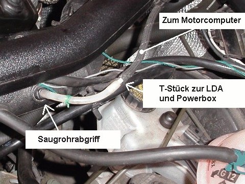

Post15-10-2004, 12:09    Subject: Turbo AFM vs. AFN: Engine Performance Differences Quote
This is the hose that Ulf is referring to.
http://people.freenet.de/golf-schrauber/LDAnschluss.jpg
Just so that no questions arise icon_wink.gif.

Post15-10-2004, 14:57    Subject: Turbo AFM vs. AFN: Engine Performance Differences Quote
dieselmartin wrote:
This is the hose that Ulf is referring to:
...and the only difference is that it's connected to a different intake manifold on the AFN engine.
Approximately where the oil change (?) note is hanging on the coolant reservoir in Marin's photo icon_wink.gif.

Post04-11-2004, 19:46    Subject: Turbo AFM vs. AFN: Engine Performance Differences Quote
Hello.
Here I am again!
I finally got an LDA that I want to install tomorrow.
It took some time because the LDA was backordered (I always seem to have bad luck).
and in the meantime, my Golf was also at the paint shop.
Now that it's shining again with its new paint job, all that's left to do is get the turbo working properly!
I've been searching for a while now, but I haven't really found what I was looking for.
where I connect the hose for the LDA.
Does that connect to the hose that Ulf already described?
dieselmartin wrote the following::
Just so there are no questions.
Approximately where the oil change reminder note is hanging on the coolant reservoir in Marin's photo.

Post04-11-2004, 21:10    Subject: Turbo AFM vs. AFN: Engine Performance Differences Quote
...only that it's connected to a different part of the intake manifold on the AFN engine.
Yes.

Post04-11-2004, 23:17    Subject: Turbo AFM vs. AFN: Engine Performance Differences Quote
ulf wrote:
Hi Ulf!
How does that work? / How is that possible?
The two long plastic tubes are the same for models 1Z and AFN (one of them has the LD temperature sensor).
How can the pressure sensor be connected there?
Does anyone have any photos?

dieselmartin wrote:
The two long plastic tubes are the same for both 1Z and AFN models (one of them has the LD temperature sensor).
How can the pressure sensor possibly be connected there?
Please see the attached file.
 File size:  81.13 KB
 Viewed:  4838 times

Post05-11-2004, 15:23    Subject: Turbo AFM vs. AFN: Engine Performance Differences Quote
@ Ulf
Okay, then AKTE is saying something different than the reality icon_sad.gif.
Since the 1Z has a nipple on the intake manifold, the lower pipe cannot be identical.
I'll take a closer look at that on the 1Z.
