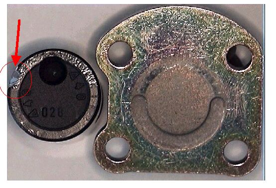

Post11-11-2003, 20:42    Subject: Broken fuel injector pump? Quote
This is damage caused by biodiesel.
'Cu Gremlin'
 Spritzbeginn-Regelkolben ausgebrochen
 File size:  53.99 KB
 Viewed:  16324 times
Translated on 08-07-2026, 6:50.
diesel.gustav
Guest
Post11-11-2003, 23:23    Subject: Broken fuel injector pump? Quote
Deleted as requested.
Gremlin
Guest
Post12-11-2003, 0:44    Subject: Broken fuel injector pump? Quote
What was the exact cause of the damage? Biodiesel itself doesn't typically cause a rupture on the pressure side of the SV (safety valve) piston.
corrosion (which is clearly visible in the upper area), leading to material fatigue and fracture. As a result, the piston is damaged...
CU Gremlin.
