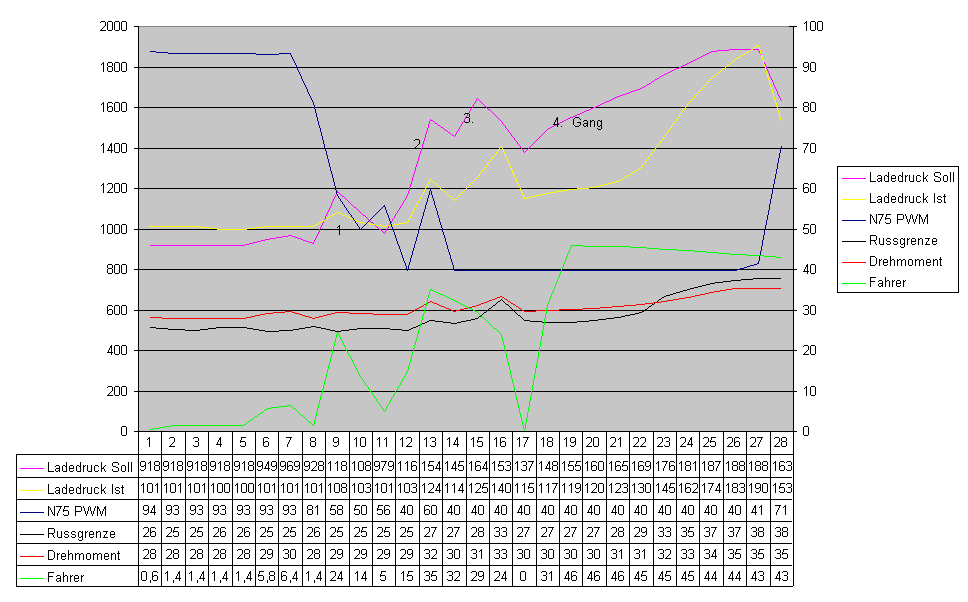

What input parameters does the characteristic curve (specifically for the 1Z) depend on?

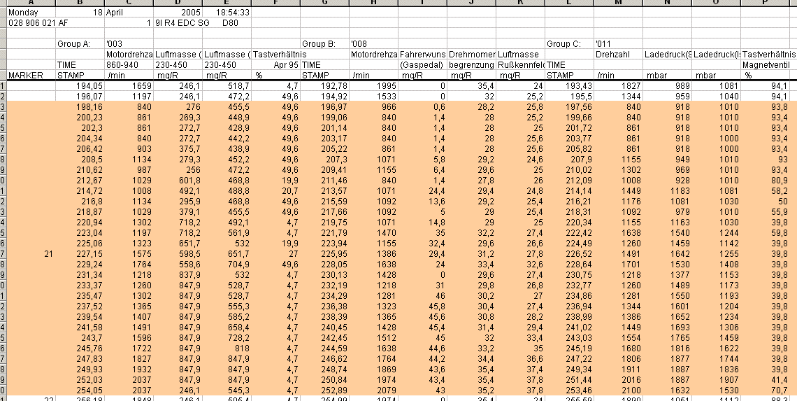

I'm experiencing a situation where the actual air mass is double the expected value (compared to the target value) at 1300 RPM, but the boost control valve is closed. Should be 2xx mg / Is 5xx mg.
When using a diode (which is permanently set to 847.9 mg), the Russian border is above the torque limit.
I can provide more detailed logs if you would like.

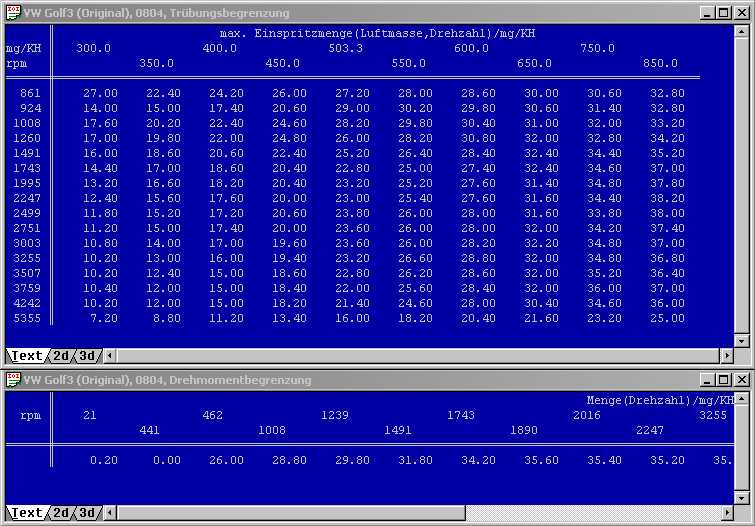

Hi Martin,
The field contains the permissible injection amount [mg].
The axes are speed (RPM) and air mass [mg].
Best regards,
Rudi
:edit:
Sure, here's the translation:
:edit:
Here's a picture showing the relevant area from the blurring and...
Torque limitation.

Post26-04-2005, 20:30    Subject: Input parameters for Russian character recognition Quote
Great, thanks, that seems to fit pretty well with the values I logged.
