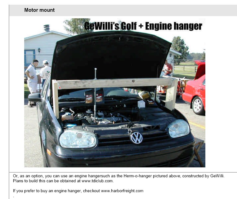

I don't think it sounds that bad. However, I don't have an engine support. Is it possible to lift or support the engine with a jack instead?
Are there any other tricks or techniques I should follow? My mechanic said it would be quite a delicate job to remove the gearbox because everything is so tight.

Removing the loose transmission was difficult. There was only one position that allowed it to be removed relatively easily. To do this, the engine had to be slightly shifted.
Once you get into that position, things start to work out.
To support the engine, I built a steel frame that rests on wooden blocks placed on the fenders.
The gearbox is also very heavy. I had real trouble getting it up into place by myself.

The G2 clearance is so tight that the engine has to be shifted significantly to the right in order to clear the gearbox and the "frame."
"Back in the day, I built the motor mounts myself: a thick 10x10cm wooden beam and a heavy-duty chain."
Here's the version of www.tdiclub.com (a4timingbelt.pdf). "a4" refers to the "Golf 4" - a fantastic 120-page PDF guide for the timing belt replacement on the G4.
