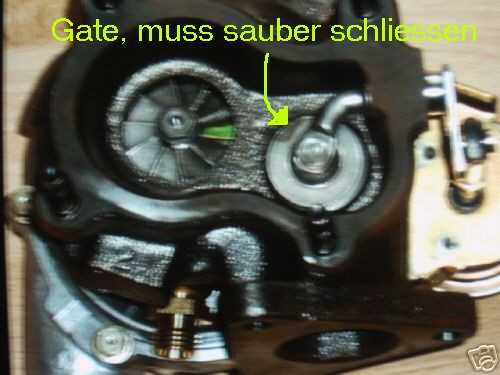

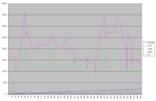

It looked like this on my end.
Especially at the 313-second mark, you have a really nice intro!
 File size:  34.96 KB
 Viewed:  2830 times

Here's some advance information on how to check the wastegate:
- Remove the exhaust pipe (these 4 screws are on the large flange at the turbo - replace the gasket).
- now you can see the gate.
- Draw up 60 ml of air into the syringe and connect it to the pressure vessel.
- Securely attach! Press firmly.
- Gate opens.
- Release the syringe; it will spring back.
- The gate closes completely (theoretically gas-tight).

If you look closely at the image I posted, you can see that the rod is pushing the gate. If you make it longer, it will always be open, and you'll have even less boost pressure!
Simple mnemonic:
The wastegate is pressure-controlled, so the pressure pushes the rod.
VTG is controlled by vacuum (let's say suction), so it PULLS the rod.
I don't believe that two turbos would exhibit the exact same defect. It sounds more like a problem originating outside of the turbos. N75, sleeping bags or something like that.
