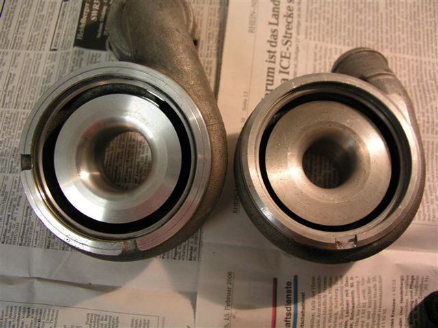

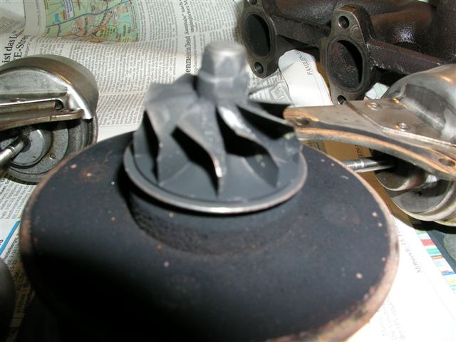

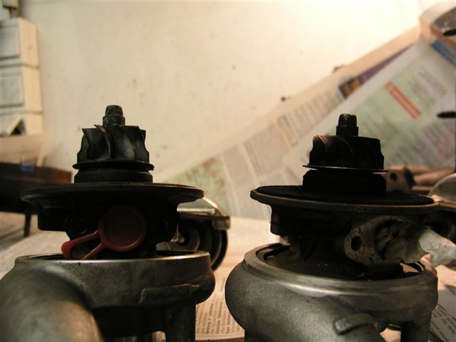

I once disassembled, photographed, and measured a KP39B.
Unfortunately, I don't have a KP39A available at the moment.

 Beide Verdichtergehäuse im Vergleich
KP39B links, KP39 rechts

 Abgasgehäuse mit VTG vom KP39B
 File size:  54.11 KB
 Viewed:  2954 times
 Turbinen im Vergleich
links KP39B, rechts KP39

 Turbine KP39
 File size:  48.48 KB
 Viewed:  3016 times
 Turbine KP39B
 File size:  53.63 KB
 Viewed:  2960 times
 File size:  65.23 KB
 Viewed:  3033 times

Post20-02-2006, 18:04    Subject: Quote
Hi Thomas,
Thank you for the pictures icon_biggrin.gif.
Could you please resize it (maximum width of about 700 pixels) and save it again, so that the width of the thread doesn't exceed my screen?
If you don't have a suitable software for that, I can do it and email it to you (but not until tomorrow evening at the earliest).
