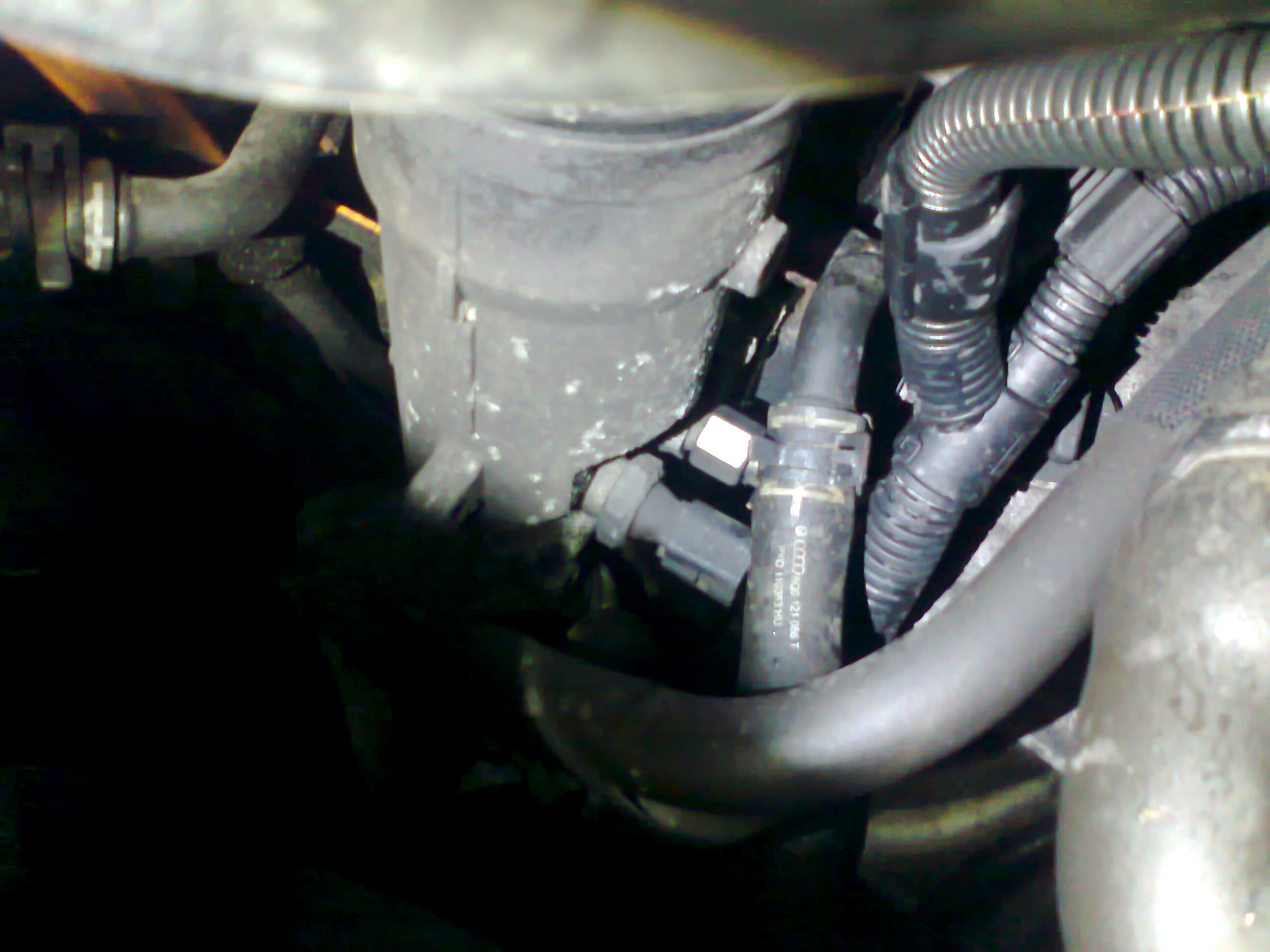

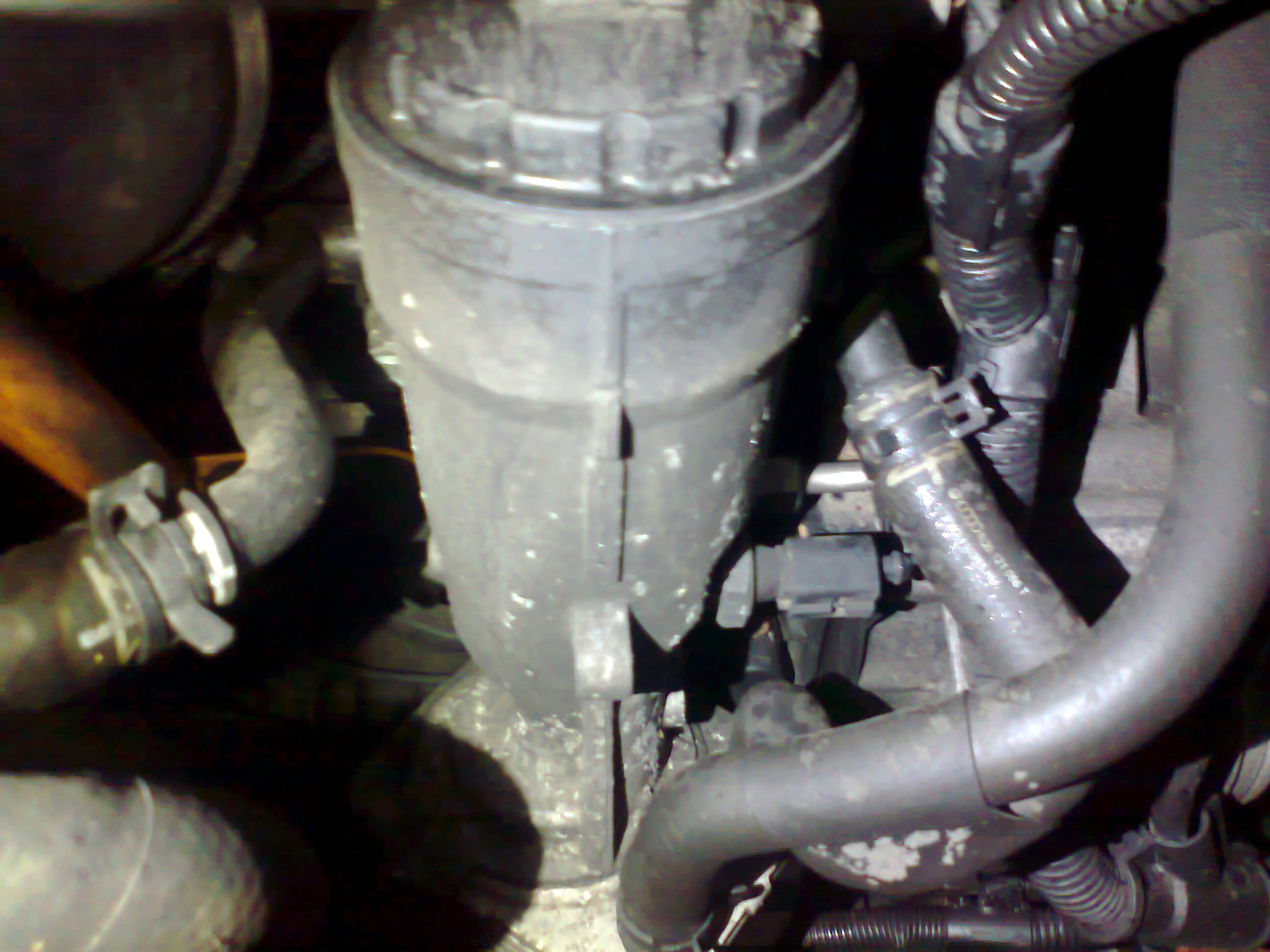

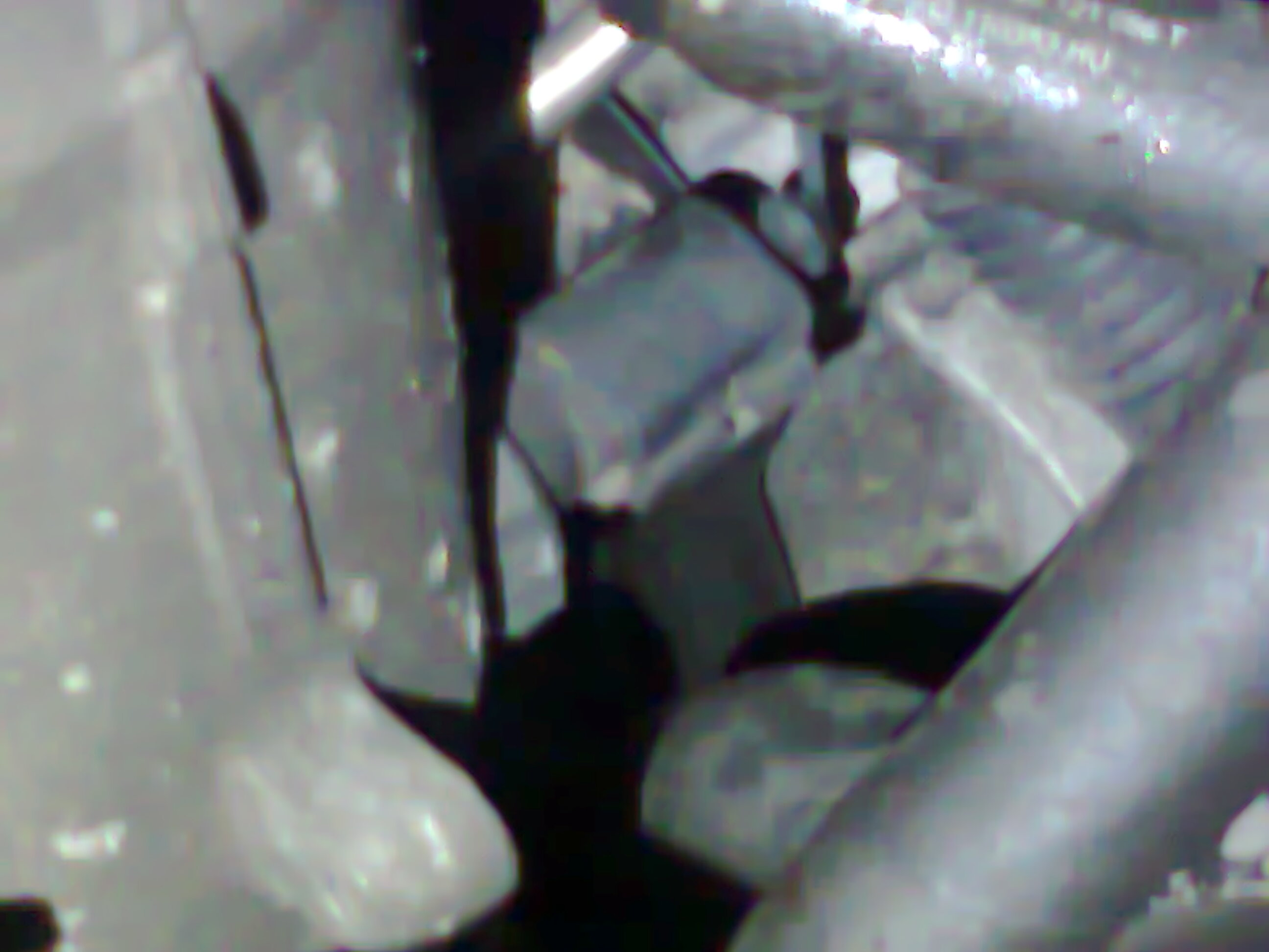

Post23-01-2012, 12:40    Subject: Oil Filter Flange TDI PD ARL ASZ Screw for Oil Temp. Quote
Hi everyone,
1.9 TDI ASZ engine, Seat Ibiza 6L, first registration 2004.
Is there an oil temperature sensor located on the right side, near the oil filter housing?
It seems to be a plug with a single-pole cable.
Can the temperature be read via OBD? In the module-specific data of the engine control unit (MSG), it always only shows 0 degrees icon_cry.gif.
"Thank you."
Jochen.

Post23-01-2012, 12:52    Subject: Oil Filter Flange TDI PD ARL ASZ Screw for Oil Temp. Quote
Hojo-Hörnchen wrote:
Hi everyone,
Can the temperature be read via OBD? In the module-specific data of the engine control unit (ECU), it always only shows 0 degrees icon_cry.gif.
"Thank you."
Jochen
It's a pressure sensor. The oil temperature might be readable in the combination instrument control unit (MIB), using the sensor located in the oil pan.
reflexsilber met.
Translated on 27-08-2026, 19:51.

Post26-08-2012, 20:32    Subject: Oil Filter Flange TDI PD ARL ASZ Screw for Oil Temp. Quote
I took a closer look the other day... the car doesn't have an oil temperature sensor located on the bottom of the oil pan icon_rolleyes.gif.
The recess is there, and there are 3 threads, but nothing else.
Seat Ibiza 6L Cupra TDI.
BUK und GUC. 136.000 Km.
