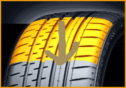

I recently saw a funny detail on a Dunlop tire: the product name is printed as part of the tread pattern in the center rib. I realize that it doesn't serve any actual purpose for the tire's function.
But what is causing this small groove/scratch in my Conti SportContact 2 tire (see arrow)?
Does it serve a purpose, or is it just for aesthetics?

"Well, I would say that they do what all those grooves in tire treads are designed to do: reduce the contact area and help prevent aquaplaning."
In this case, the water cannot flow laterally, but rather downwards along the pronounced grooves (front and back). If these grooves are only faintly indicated, the effect would naturally disappear with wear. Perhaps an additional indicator for wear could be added?

Water cannot pass through the groove; only the highest level of "mist" can.
It's no bigger than 1x1mm, and I'm surprised it hasn't worn away yet, because the Passat already puts a certain amount of stress on the tire.

I suspect that it has a similar effect to the sipes in winter tires, and in this case, it increases grip and handling on wet surfaces. They certainly aren't free, but the water is drained away by the tread pattern. Incidentally, many countries also drive with summer tires in the winter, including where I come from icon_redface.gif.

Since the groove runs lengthwise and not crosswise like with a lug pattern, it cannot be compared to a lamellar function.
Besides the optical function, I can only imagine that new tires might offer better grip in curves, but 1 mm is a negligible amount.

1) Since the groove runs lengthwise instead of being oriented transversely like in a ribbed tire, it is not comparable to the fin function.
2) Besides the grip function, I can only imagine better adhesion in curves with new tires
"I suspect there's a lamellar function at play, but not for propulsion (as I mentioned above)."

'Does anyone know what the maximum connected tread area is allowed to be for a road tire?'
Right here is where I see the purpose of these micro-grooves. With such fine segmentation, I lose very little stiffness in the profile block and get significantly closer to the 'slick' surface that is considered illegal by governing bodies.
The tire's steering precision improves because the tread block has a large, continuous contact area.

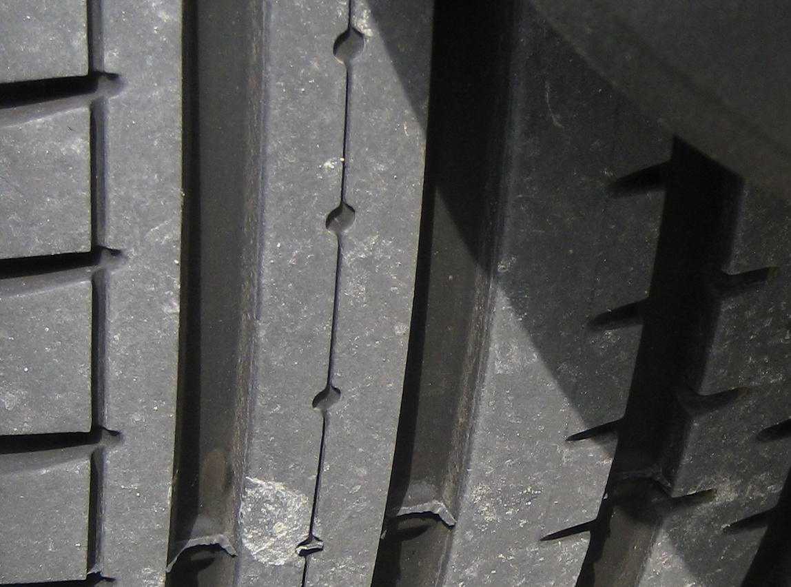

Here's a real photo of the mini-groove.

Meine jedenfalls sind auf knapp 4mm herunten, und das nach 20tkm? I hope that...
I'm curious to see where that puts me on average. While the front tires are practically brand new,
Even that small groove with the circular indentations is still there, just like you described in a thread.

I have a noticeable saw-tooth pattern on the front [of something, likely tires or a component]. Additionally, I experienced slight vibrations in the car during a 1300 km journey.
The small groove is still present at the back, but it's completely gone from the front.
