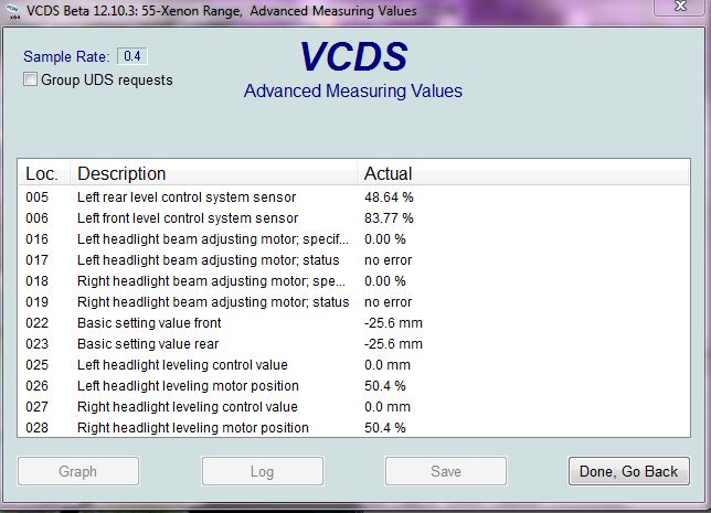

Does the actuator diagnosis provide plausible results?

Please provide the relevant part of the Autoscan and screenshots.

Post24-03-2013, 18:57    Subject: T5 GP D(?)LWR 6R0 907 357: Can it be decoded? Quote
Measurements taken with the car loaded with approximately 70 kilograms in the trunk:
 File size:  66.64 KB
 Viewed:  3246 times
VW T5 GP Multivan Startline CAAC 2,0 CRD 103 KW, Audi A2 1,4 16V AUA 2001, Audi A2 1,4 16V AUA 2003;Renault Zoe PHII 135 2020;

Post24-03-2013, 20:39    Subject: T5 GP D(?)LWR 6R0 907 357: Can it be decoded? Quote
Why don't you try the basic settings?
Output tests are something completely different.
What does the mask look like at the differing position in the LCode?
Translated on 03-08-2026, 1:58.
Mc_Givertechnik
Joined: 02/27/2003
Posts: 390
Location: Graz Österreich
2010 Volkswagen T5
Post24-03-2013, 20:56    Subject: T5 GP D(?)LWR 6R0 907 357: Can it be decoded? Quote
Hi Rainer!
"That's the main problem: while the basic settings can be performed, the values apparently aren't being saved. I've tried performing the basic settings multiple times, but without success. The existing error cannot be cleared. As soon as I clear the error, you can hear the headlight actuators humming, and then the error reappears."
"L-code mask?" Please don't hit me, but could someone explain this to me briefly?
Greetings,
Peter.
Translated on 03-08-2026, 1:59.
