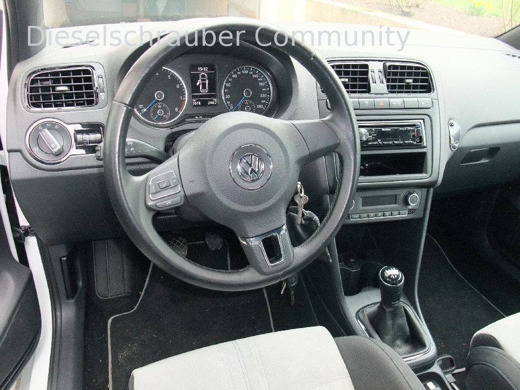

MFA+ is likely the correct model, see the picture. This is the Polo, and the Rapid has the same type of instrument cluster (with other details like a shorter speedometer scale and white pointers...).
If the only way to get the Polo to work with a certain feature is through the RNS315, does that mean it has to stay installed? Because in the long run, I'd prefer to use the smaller radio.

Joined: 04/13/2002
Posts: 11058
Location: Saarland
Post10-05-2015, 16:38    Subject: Automotive Network Security Standards: Questions Quote
I've now checked the box "TFL can be activated by the driver" in the BNStG settings. However, this did NOT create a new TFL option in the "Lights & Visibility" menu of the FIS.
Or should I be looking elsewhere, or perhaps doing something additional?
Translated on 03-09-2026, 15:52.

Joined: 06/22/2005
Posts: 4636
Post10-05-2015, 19:39    Subject: Automotive Network Security Standards: Questions Quote
The checkmark activates the corresponding menu entry in the MMI, but that entry must be configured in the MMI beforehand. The question is whether it's possible to display that entry in the FIS menu. In your configuration, there's no MMI. While there's a development test mode for the radio (which I also found in the Polo), I don't know what that mode contains for the Polo radio, or how to access it. In the A4 with MMI 3G, it works seamlessly; I use it to turn the TFL (Traffic Light Assistant) on and off.

Post11-05-2015, 6:48    Subject: Automotive Network Security Standards: Questions Quote
Herbert wrote:
In your configuration, there is no MMI.
The RNS315 also had a multimedia interface with a port in the glove compartment.
I've never used this thing, but I could try installing it again for testing purposes.
Do you think it might be possible to control the TFL via the RNS315? icon_eek.gif
Translated on 03-09-2026, 15:55.
