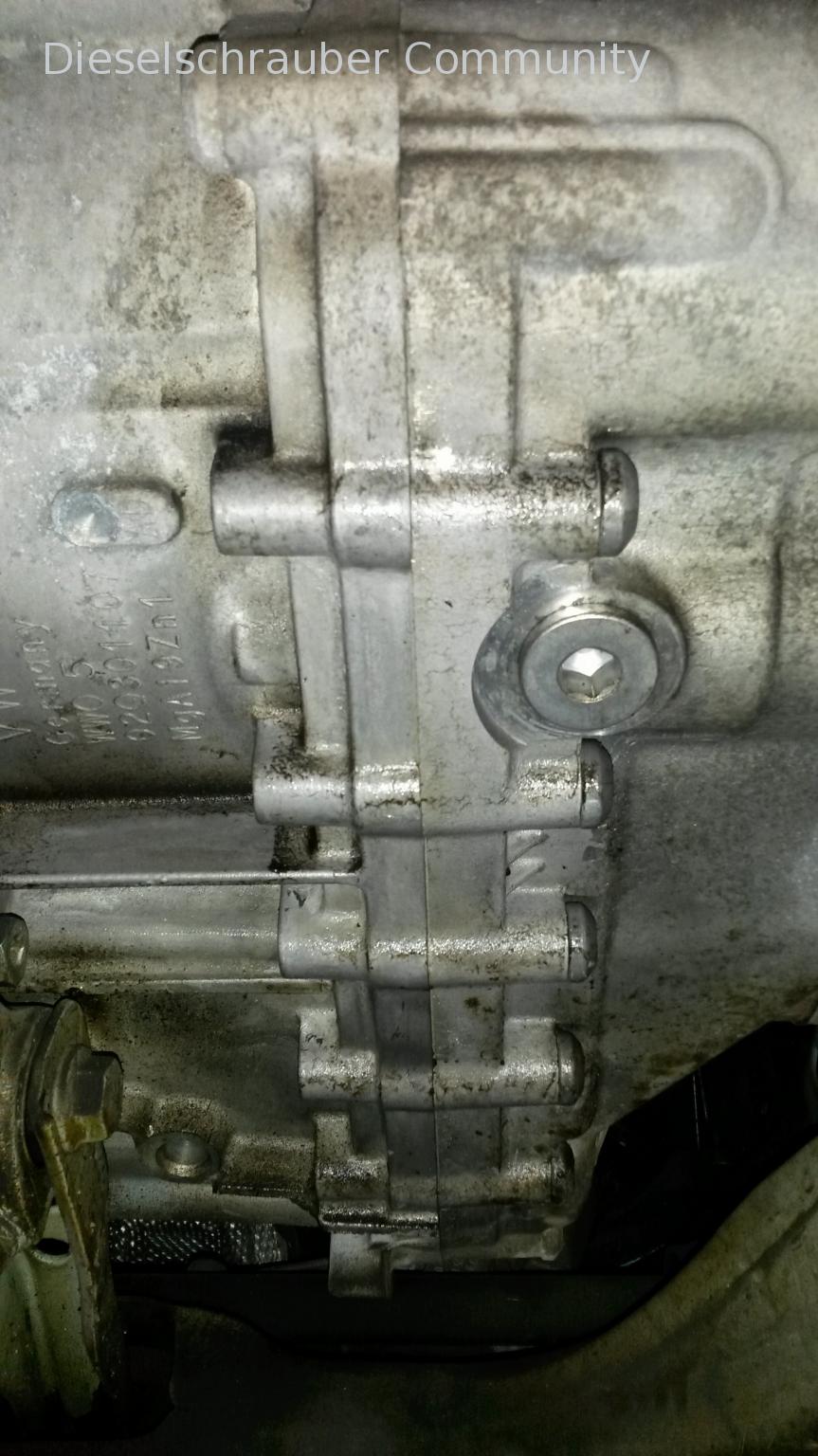

The manual transmission in my Golf 7 GTD (34,000 km, manufactured in 2016) is leaking slightly.
The leak is located between the two transmission housings, not between the engine and the transmission.
The workshop wants to reseal the screws (but how are they going to do that?).
If that's not enough, the transmission will need to be removed and resealed.
Are there any experiences with this transmission? It's used in a large number of vehicles.
I'm worried that they might simply tighten the screws too much, which could cause problems later on, or that they might not be careful when removing the transmission.
I still have a 2-year warranty.
The yellow substance on the torque arm in the picture is not oil, but wax.

Are you sure that's transmission fluid?
Sollte man schon am Geruch erkennen. Es kann aber auch verflüssigtes Schutzwachs sein, das sich unten am Getriebe sammelt. Or engine oil.
If you verschandeln the gearbox with brake cleaner, it should be easier to identify the source of the problem.
If there is still a warranty, your dealer should handle the issue. I don't think pursuing it further will achieve anything. If necessary, consult another dealer.

Yes, it is transmission fluid.
I've already been to two different dealers. Both of them want to seal the screws first?
I don't think this will achieve anything, and I'm already mentally preparing to remove the transmission.
There are two variations:
1. Resealing.
2. New gearbox.
In the first option, it's possible that the gearbox halves may not be perfectly flat, and you might need to return to the workshop after 1-2 years, although this is without any guarantee.
Therefore, I am in favor of the second option.

Post03-11-2017, 21:26    Subject: Golf 7 GTD manual transmission has a slight leak Quote
If you ever verschandeln the transmission with brake cleaner, it should be easier to find the source of the problem.
I agree. First, we need to verschandeln everything up and figure out where the oil is actually coming from.
And this should primarily be done by a workshop.
Since the housing parts are likely sealed against each other as usual, tightening the screws to create a seal is pointless. You can only tighten them to the specified torque; nothing more.

Post05-11-2017, 9:35    Subject: Golf 7 GTD manual transmission has a slight leak Quote
It's coming 100% from the seam between the two gearbox halves.
I believe that sealing the screws is pointless (according to the workshop).
So, the transmission needs to be removed.
To be absolutely sure that the transmission halves are not warped or damaged, it's best to use a new transmission.

To be absolutely sure that the transmission halves are not warped...
...the clearance is checked with the screws loosened.
Laß sie die Schrauben "neu abdichten" und verlange eine Stellungnahme von VW zum Schaden. Über die Werkstatt. IAre you guys from Volkswagen, or what?
