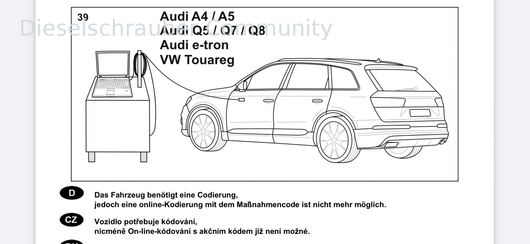

 Hier die Beschreibung der Einbauanleitung....

I would carefully review the coding options available in the instrument cluster/dashboard (address 17) and the trailer control unit (address 69) using the L-code.
If the indicator lights for trailer turn signals are always illuminated on the instrument cluster, it can only be due to one of two reasons: either the instrument cluster is not receiving information from the trailer control unit about the status of the trailer turn signals, or it is receiving incorrect information.
Could you please share some screenshots of the trailer control unit's coding options?
How does the trailer control unit detect whether the trailer turn signals are working? Are these connected directly to the trailer control module, or is the signal taken from the rear turn signals, and does the trailer control module check if there is current flowing?
In the latter case, it might be incorrectly connected and not receiving the electrical current, which would explain the illuminated symbols on the dashboard.
