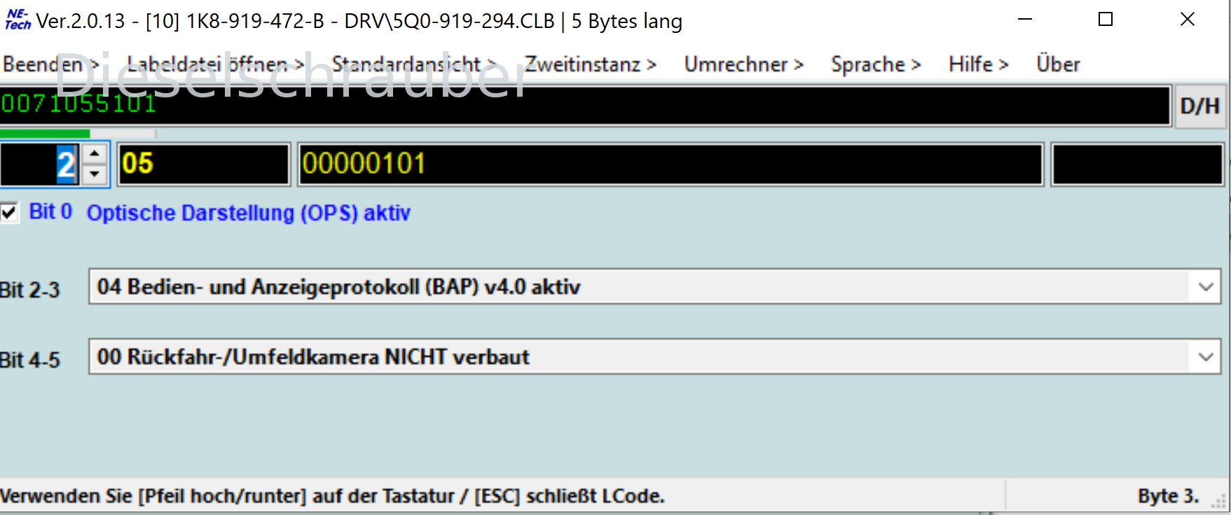

Post27-08-2021, 20:39    Subject: Information electronics restarts / shuts down Quote
Hello.
Unfortunately, I haven't become any wiser.
As far as I can tell, everything seems to be okay with the coding.
The OPS (Obstacle Pre-Scanning) feature is active in the parking sensor coding, as shown in the Screenshot. Reordering the values didn't make any difference.
There's nothing to find in the "Radio" section of the encoding, but there are a lot of adjustments there, although they are incomprehensible to me.
As far as I can tell, the firmware is the biggest difference between the devices.
The "B" models have firmware in the 200s, while the "D" models have firmware in the 300s. A change is not planned by VW.
My friend is checking to see if he can get anything else.
I just ran a recent car scan and have attached the results.
Thank you for your efforts!
SG
