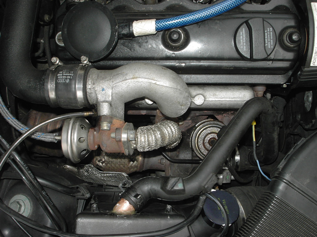

Based on the idea that the turbo isn't getting as much air as it should, I have now made some changes.
1. The engine ventilation system no longer works with the turbo, but with a plastic bottle filled with cotton. (Cotton for oil separation)

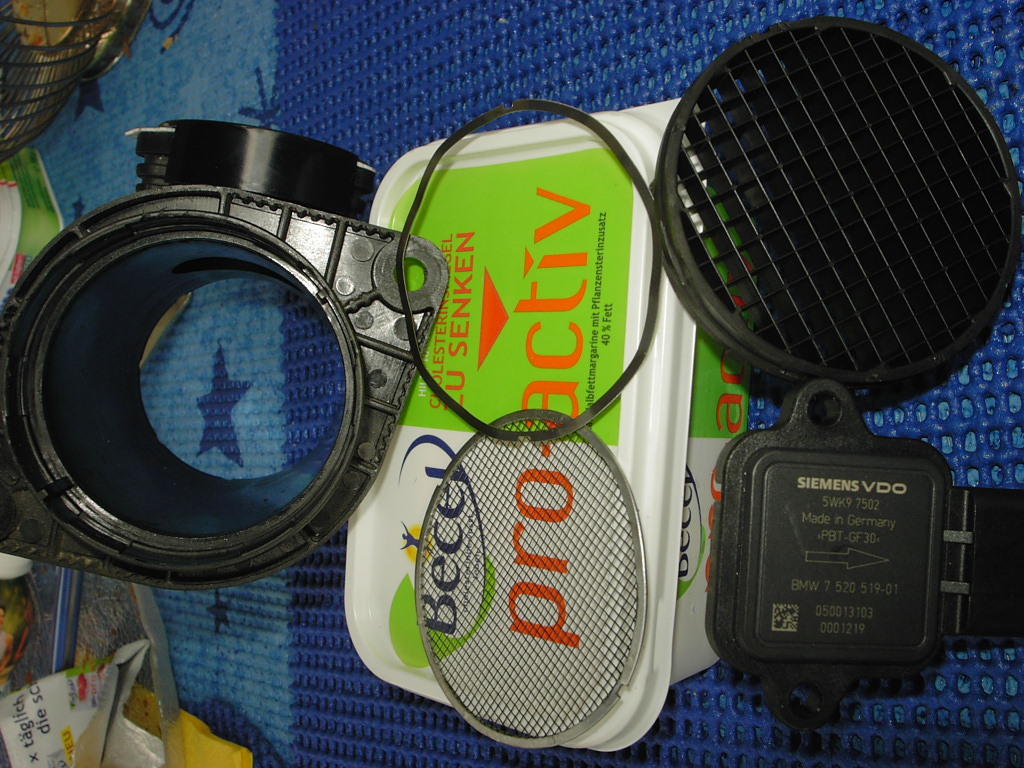

2. The vacuum hose from the turbo is routed to the air filter housing, as a bypass to the IAT sensor. This was also necessary because the IAT sensor, when exposed to a certain amount of airflow, starts to provide a decreasing output signal, because the excessive airflow essentially overloads it. This effect has been reduced. On Image 2, you can see this clearly.
One of the main causes of the intake air pressure drop is the filters on the LMM. After some consideration, these, along with the LMM sensor, were completely removed, and the resulting hole was closed with a cover. The signal from the LMM is now obtained from the speed up to approximately 0.1 bar of intake pressure, and then only from the intake pressure. The circuit is set up so that there is always enough air mass reported from the moment the boost pressure is applied. Below the boost pressure, it should not result in noticeable smoking.
Which mass flow sensor was in use up to that point is shown in Figure 1.
A significant effect does not occur, (is it ?), but it is clear that it will reduce the speed of my worn-out VNT15.
I don't have a vacuum gauge, but using a hose filled with water, I was initially able to confirm a loading pressure of around 80-90 mb (1.3 bar/3800 units per minute). Now, it's around 40-50 mb.
(Furthermore, due to the lack of engine compartment exhaust, he now also gets more oxygen. Percentage unknown)

Incidentally, one can also see the LDA inlet with a model-made nipple in the intake bridge.
