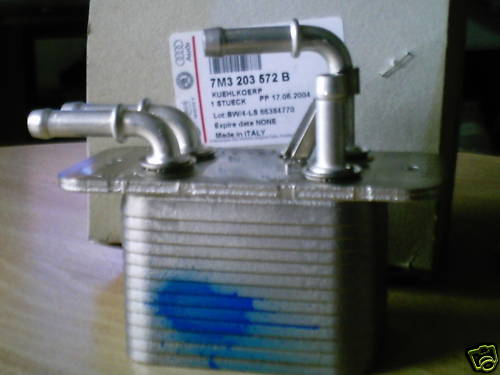

The "egay link" is the radiator.
On December 16th, I got it for 1 EUR... and it was BRAND NEW!!

The part looks like this:
 File size:  20.1 KB
 Viewed:  4039 times
vwSchrauber
Joined: 09/18/2008
Posts: 1262
Post22-01-2010, 15:45    Subject: Quote
Exactly - it's small, but it should be enough for the windshield washer fluid.
