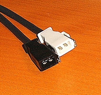

Posts: 18138
Post15-08-2005, 20:48    Subject: Audi A6 C4 Diagnostic Connector Quote
olli wrote:
These connectors are available for 8 cents at Conrad. And in contrast to the description and a comment here in the forum, there are actually all 4 contacts included, and not just 3.
Greetings from Berlin
Olli
slow down, it seems like someone here has read the topic and immediately went for the soldering iron / EBUCHT waste disposal:
...I don't know anymore if it stopped working immediately, or only after...
for a while.
I have a 2 x 2 adapter and I might have plugged the black plug in once.
attempts to insert into the black box on the vehicle because the
The terminal orientation is not immediately apparent due to poor lighting in the engine compartment.
If the device is inserted incorrectly,
...the problem could be due to this...
Incidentally, this is the owner of a C4 icon_evil.gif.
So, wer also sein Diagnosegerät beschädigen möchte, weil icon_smile_thumb_up.gif die 2V und Masse vertauscht wurden (und zwar mit einem vernünftigen 2x2 Adapter, Kabel oder Stecker, die egal wie passen), hat sozusagen Pech gehabt.
I somehow suspected this with the FGB1 and even prepared for such specialists, in which case the power supply is provided via a diode. However, if someone builds a "killer adapter" and suddenly reverses the power supply of a 200-400€ diagnostic device, this will no longer be covered under "warranty" for me. icon_evil.gif
With a reasonable 2x2 adapter, the connectors will not allow for incorrect insertion! And because of the metal retaining clips, the connectors also don't just fall off like other waste!
And since I'm just venting my frustration right now: What do you think, why are there no China-2x2 adapters or diagnostic connectors available in this shop?
Okay, let's do it. Because the businessman wants to make so much money through his systems?
No, even though the Chinese were sending me emails/FAXs full of nonsense because I had looked at their waste and found it to be genuine waste!If it wasn't manure, it would have been included in the offer by now!
Hello, Rainer
