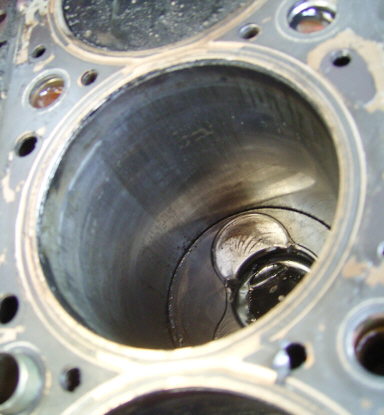

Okay, I just picked up the car with the trailer.
I initially thought about the cheaper repair option involving the cylinder head and pistons, which I could do myself. However, now I can see scratches on the cylinder wall, indicating that the piston was likely slightly warped. And on the exposed part of the piston, there's evidence that a valve has been hitting it for some time.
It hasn't consumed anything, and there's absolutely no noticeable difference compared to a healthy engine. Furthermore, another one also has similar markings, but the compression test that was previously performed was okay. It also never consumes oil. The other two are perfectly fine.
You can see it... please give me your opinion, is it junk or something you should try despite its flaws? Here's the picture:
 3.Zylinder mit Spuren.
 File size:  32.56 KB
 Viewed:  3050 times
Translated on 18-09-2026, 14:01.

No one can guarantee that the block and everything inside it will last forever.
For me, the decision-making process would go something like this: If the car is expected to last another 200,000 kilometers or more, then it's ready to go as is.
Given that there are still 100,000 km to go, it depends. If I can do a lot of the work myself and get away with a €500 eBay cylinder head plus small parts, I would do that first. If the connecting rod bearing was damaged, I can always replace it later when the new head is installed. If it turns out that the crankshaft is bent or there's something else serious wrong with the block, I can still replace it with another used one. In that case, I would only have to do the cylinder head work twice.
Do I have to go to the mechanic for every little issue, or can I possibly have a TDI engine installed by a reputable workshop with TDI experience?
Working hours are expensive for a workshop, making it impossible for them to afford repairs that are only partially completed. If you can do the work yourself, the cost calculation and the risk assessment look different.
