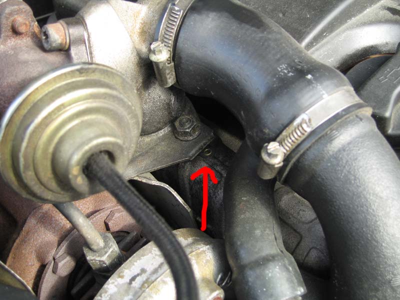

Post06-03-2006, 14:08    Subject: Intake Manifold Gasket: Replacement Guide Quote
Here's how it looks on the Audi. You can see a piece of the seal where the red arrow is pointing.

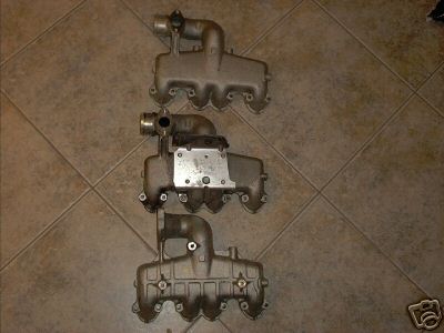

Joined: 03/13/2003
Posts: 10121
Location: in der Werkstatt
Post06-03-2006, 14:53    Subject: Intake Manifold Gasket: Replacement Guide Quote
I know that one, that's the old AAZ adapter.
Then it seems that the Golf 1Z is truly the only one that doesn't have any real storage space.
All other TDI engines, as well as the JX and AAZ models, have a fitting that is a type of chamber with four outlets.

Post06-03-2006, 17:14    Subject: Intake Manifold Gasket: Replacement Guide Quote
Wolfi is right!! It looks like that, just like in the picture!!
And Wolfi, the friendly one, actually had a stamp on hand for me, and it cost just under 5 euros.
Thank you for your help.

Joined: 03/13/2003
Posts: 10121
Post07-03-2006, 9:24    Subject: Intake Manifold Gasket: Replacement Guide Quote
@ Steffarn
You wouldn't believe how many bridges there are for the VAG R4 diesel trains icon_eek.gif.
"I am especially confused by the concept of 'evolution'."
AAZ - with chamber, and these light ribs on the outside.
1Z - no chamber, no ribs.
after that - always pork loin, mostly ribs.
