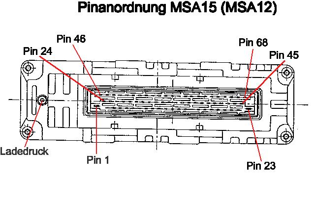

The MSTG unit is self-sufficient in terms of its supply needs for the 109 vehicle.
It's true that it tends to break easily (  search); but I think - I believe - that's not your problem.
I suspect that the ignition power supply (pin 38 MSTG) is always active.
If you unplug the connector on the MSTG (after disconnecting the hose) and with the device turned off, ...
If you're getting 12V on pin 38 when the ignition is turned on, all you need to do now is find where that 12V is coming from.
(Ignition switch?)
Best regards,
Rudi

Thank you for the drawing.
Unfortunately, it's not clear from this where PIN 38 is located. Could you perhaps provide another diagram? Also, could it be a damaged cable that was broken during the starter removal and installation process? The cable harness runs in that area.
Do you happen to know where I can find a wiring diagram for the cable harnesses?
And thank you again for your help.

04-04-2006, 20:15 Subject: Re: Engine won't shut off - Load signal for generator terminal |
Quote |
Aus dieser ist leider nicht ersichtlich wo der PIN 38 ist...
But it  is }.
Sure, it's possible that you damaged the wiring harness while installing the ignition coil, and as a result...
12V can appear in places where they shouldn't necessarily be.
Best regards,
Rudi

04-04-2006, 20:44 Subject: Re: Engine won't shut off - Load signal for generator terminal |
Quote |
But it
I'll try a slightly different approach; maybe it will be clearer  .
