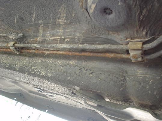

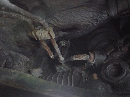

Post10-06-2006, 14:43    Subject: What does the TÜV say about these brake lines? Quote
I need to go to the garage soon and I found this under my car...
Do you get a medal or a slap?
 File size:  36.86 KB
 Viewed:  6929 times
 File size:  27.8 KB
 Viewed:  4894 times
tdi-schrauber
Joined: 01/17/2006
Posts: 101
Post10-06-2006, 17:06    Subject: Re: What does the TÜV say about these brake lines? Quote
Hello!
Looks like a punch in the face!
I would take care of it in my own interest.
BYE
TDI-Mechanic
Marco
Guest
Post10-06-2006, 18:16    Subject: What does the TÜV say about these brake lines? Quote
My old Corsa passed the TÜV inspection with similar-looking hoses, despite having no problems.
Arno
Guest
Post10-06-2006, 18:20    Subject: What does the TÜV say about these brake lines? Quote
It doesn't look better in some places. The MOT test didn't have any issues with it. You can sometimes only see the rattling if you remove the lower engine cover.
Are there any (prescribed?) replacement intervals for the lines, and what criteria are used to determine if the lines are nearing the end of their lifespan?
vagtuning
Guest
Post10-06-2006, 20:14    Subject: What does the TÜV say about these brake lines? Quote
Well, I would also replace them soon - mine were only in a 100th of the condition (a little bit of green rust and very light surface rust) and there was no TÜV (German vehicle inspection), which I also fully support, as it saves money on steering and braking systems!
Arno
Guest
Post10-06-2006, 20:18    Subject: What does the TÜV say about these brake lines? Quote
The steering and braking systems should not be compromised!
Tell that to the people in Wolfsburg icon_wink.gif. My 15-year-old Passat had far from the vibrant landscapes that my current 35i icon_evil.gif has.
vagtuning
Guest
Post10-06-2006, 20:44    Subject: What does the TÜV say about these brake lines? Quote
Well, I was also very surprised at the signing, regarding the vehicle - my 2er, which had been unregistered for over a year and was sitting outside, had nothing like that icon_smile.gif
Joined: 03/13/2003
Posts: 10121
Location: in der Werkstatt
Post11-06-2006, 10:10    Subject: What does the TÜV say about these brake lines? Quote
YES, my two G2s also didn't have this, and they were significantly older than the G3.
I'll let the TÜV take a look at it...
thanks
Joined: 07/27/2004
Posts: 2405
Post12-06-2006, 7:06    Subject: What does the TÜV say about these brake lines? Quote
I once pressed the brake pedal during a full stop while driving my (now deceased) grandmother's car.
When I looked at it afterward, it didn't look significantly worse than yours in the front area. So, icon_arrow.gif act in your own interest and switch quickly. Unexpected braking on two diagonally positioned wheels can be quite frightening icon_smile.gif
Greetings
Guste
Joined: 03/13/2003
Posts: 10121
Post20-07-2006, 10:55    Subject: What does the TÜV say about these brake lines? Quote
Okay,
I will still get the lines done (installed) next month, but then without any rush and without inspection fees.
I had the "pipe" cleaned.
BM
Avatar-BM
Joined: 12/07/2005
Posts: 1857
Location: Nähe Düsseldorf
Post20-07-2006, 14:41    Subject: What does the TÜV say about these brake lines? Quote
...My grandmother once pressed the brake pedal during a full stop.
I've had that too. It was a beetle back then. The pipe was exactly in a rubber fitting, completely corroded and invisible from the inside.
"It used to be normal for brake lines to rust. People would then clean them with wire brushes or sandpaper and then treat them with zinc dust paint or aluminum spray, or something similar."
However, if the rust has penetrated so deeply that pores are already present, there is only one way --> to renew.
