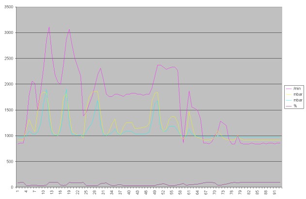

Okay, now I have a small log.
See for yourselves.
LOG-01-003-008-011.xls
 hab das originale log auch noch
 File name:  LOG-01-003-008-011.xls
 File size:  66.5 KB
 Downloaded:  390 times

Here's the table and the chart again.
LOG-01-003-008-011mit_Diagramm.xls
 Boost pressure fluctuates at partial load, according to LDA

Post02-06-2006, 8:38    Subject: Boost pressure fluctuates at partial load, according to LDA Quote
Your N75 is desperately trying to boost the turbo pressure.
35.2% keystroke rate, but the turbo function doesn't do anything.
0.2 bar of boost pressure instead of the desired 0.8 bar (at 14.67 seconds).
Is your turbo stuck?
Does the shaft rotate easily with almost no play?
Does the wastegate close properly?
Yesterday, I was holding a turbocharger, and the wastegate (the cover on the arm) was rattling. Maybe something is stuck in yours. The pump rarely reaches its target pressure.
You should have kept the throttle open longer during the measurement; you never see the typical wave pattern of the turbocharger pressure regulation.
