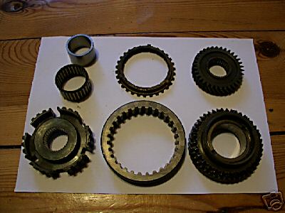

I thought that because of a different number of teeth, the entire gear would be different (with a different diameter), and therefore the synchronizing ring, etc., wouldn't fit.
We had a lot of fun messing with that T4, trying to give it a really long fifth gear.
| Description: |
| long 5. Performance is down -> what to do??? |
| File size: |
26.61 KB |
| Viewed: |
13284 times |
| Back to top |
Profile PM Garage |
BlauBaer Guest
25-10-2006, 14:42 Subject: long 5. Performance is down -> what to do??? |
Quote |
No... everything fit perfectly again... we really only changed the gears.
I was also thinking about whether to replace the needle bearing right away... but it doesn't matter... I'll do it when it starts to whistle  .
Did you have to replace all of that on the T4? That's strange, because those gears are from a T4 transmission. Well, I guess you don't have to understand it.
The gear itself is only different in diameter compared to the second gear, which also needs to be replaced.
Where the synchronizing ring is located, everything is still as it was before. At least, everything is working perfectly for me  .
