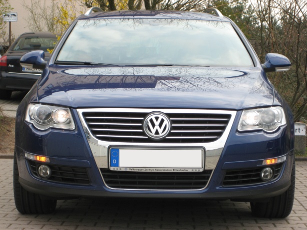

The CAN cable needs to be worthwhile, so I'm diligently working on the 3C.
Does anyone know what percentage of PWM (Pulse Width Modulation) duty cycle the turn signals have when used as auxiliary lights (stand lights) in American cars?
I set it to 14%...
Ross-Tech-Support
Joined: 05/30/2005
Posts: 646
Post29-03-2007, 22:06    Subject: What percentage of PWM do American turn signals have as parking lights? Quote
Bem Golf/Jetta 20%, but there is no such thing for the Passat.
Joined: 03/13/2003
Posts: 10121
Location: in der Werkstatt
Post29-03-2007, 23:03    Subject: What percentage of PWM do American turn signals have as parking lights? Quote
What do you mean by "not at all"?
I have, at least, coded it this way:
STG 09 Byte 7 Value 15
... and as expected, the turn signals (front) function as additional parking lights.
Joined: 03/13/2003
Posts: 10121
Post30-03-2007, 12:31    Subject: What percentage of PWM do American turn signals have as parking lights? Quote
and that's how it looks:
 File size:  105.36 KB
 Viewed:  1082 times
