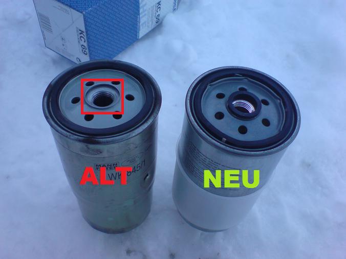

So, I went to the parts dealer today and bought a diesel filter, a check valve, and a meter of fuel line.
During the installation of the aforementioned parts, I noticed the following:
- The installed return lines were quite stiff and showed some slight cracking at the ends (although any major damage was not immediately visible).
- The check valve located on the filter appeared to be the original one, which meant it was probably about 14 years old.
- and as a "highlight," I noticed that the inner seal was missing from the diesel filter when it was installed (see attached image) ..... could this alone have caused the problems?
I was amazed by the fact that the car started immediately and without any problems after assembling all the parts: It has never started so smoothly since we've owned it. Although I had filled the filter completely with diesel, I had assumed that I would still have to wait a long time for all the lines to fill up.
Well... let's see what this Wednesday morning brings...

Feinstaubkönig wrote: | ...
- and as a "highlight," I noticed that the inner seal was missing from the installed diesel filter (see attached image) ..... could that alone have caused the problems? ... |
Are you absolutely sure that the "missing" gasket isn't stuck to the bottom of the DiFi holder? Did you check that before installing the new DiFi (with the mirror)?
I can't imagine anyone installing a filter with a missing inner sealing ring. On the other hand, it happens very often that the old sealing ring remains stuck to the holder!

DieselBär30x wrote: | | Are you absolutely sure that the "missing" gasket hasn't gotten stuck to the DiFi holder BELOW?? |
Yes indeed, I am absolutely certain!
My first thought was actually the same as what you wrote... but there was definitely nothing left there.
