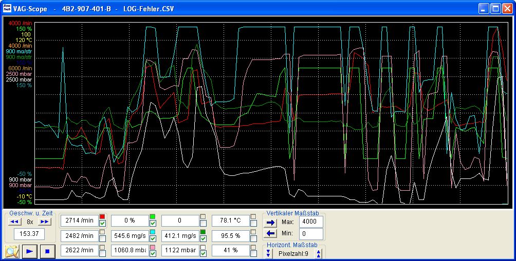

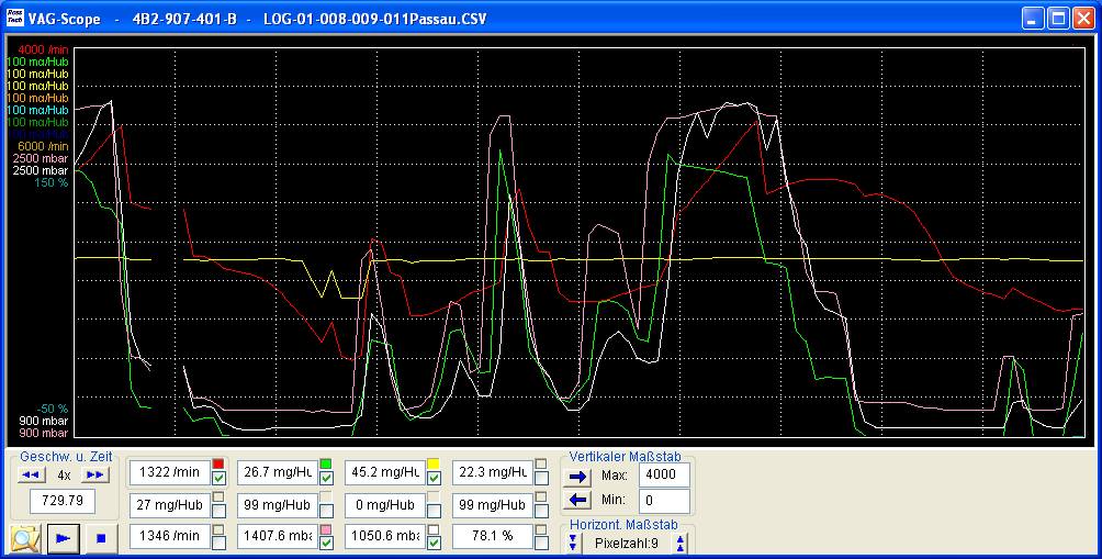

Here's some information regarding the issues of "intermittent lack of power" and "turbocharger engagement."
 Turbo spät, wenig Leistung?
 File size:  114.16 KB
 Viewed:  1127 times
 Plot vom Problem, 100% Gas ohne Leistung, am Ende wieder normal...
 File size:  149.18 KB
 Viewed:  913 times
