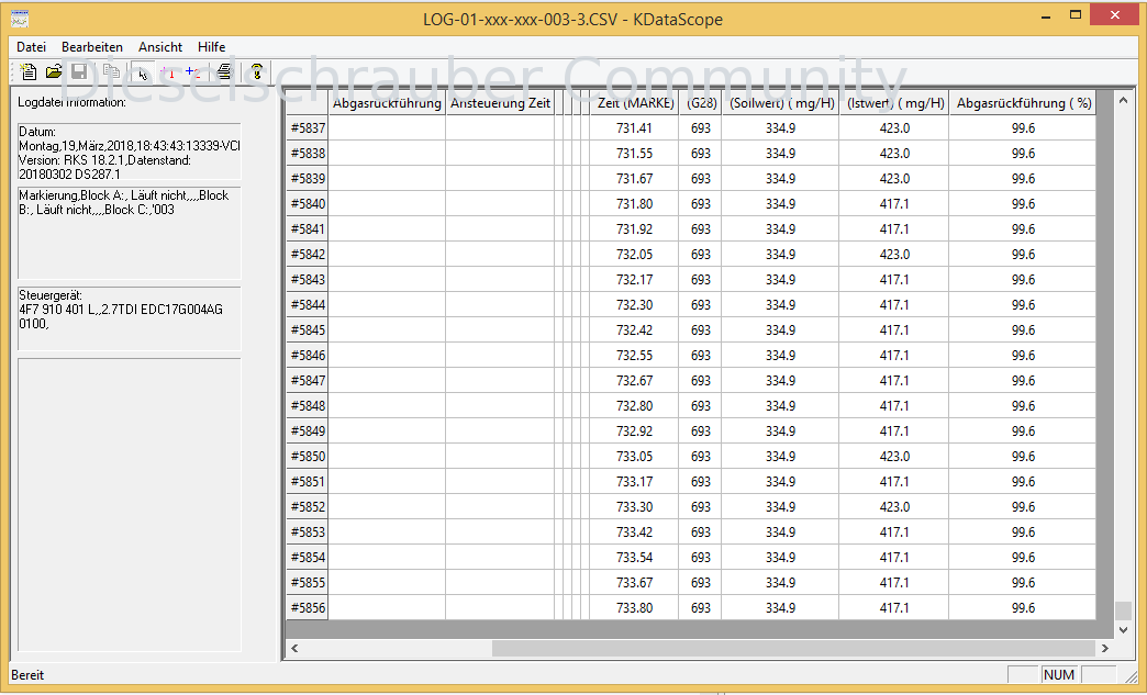

Yes, I have the correct EDC17.
Another question about AGR.
How should one understand the control of exhaust gas recirculation (EGR)?
It's constantly showing 99.6% for me.
Is it always on or always off?
The target and actual values never match.
Error memory is empty.
DPF at 0.30, full, last regeneration 370km ago.
See the log file.
Log file now in original VCDS format.
LOG-01-xxx-xxx-003.CSV

Post19-03-2018, 20:01    Subject: Exhaust Gas Recirculation (EGR) Repair Quote
I suspect that you can't adjust anything with your system. It depends on the engine control unit, and besides, it would be illegal.
When it comes to logs, please don't modify them in any way, but upload them exactly as they were recorded on the hard drive.
Your AGR (Abgasrückführung) system isn't working correctly; more specifically, it's not closing properly (due to a mechanical defect), or the pipe to the turbocharger is completely clogged with carbon deposits or almost blocked, or someone has tampered with the data set.
Translated on 30-09-2026, 16:19.

Post19-03-2018, 20:42    Subject: Exhaust Gas Recirculation (EGR) Repair Quote
Nothing was changed in the dataset.
I have uploaded the originally recorded file.
No. I'm not writing this for no reason. Sometimes, when converting files, a) nonsense happens, and b) it's unnecessary. I see you just uploaded a file with commas, but that one looks messed up too.
Marker, Block A:, Not running,,,,Block B:, Not running,,,,Block C:, '003
Engine speed, exhaust gas recirculation, exhaust gas recirculation, control.
Time,,,,,,,,,,,Time,,,,,Time,(Target value),(Actual value),Exhaust gas recirculation.
Label, BRAND, , , , , , , BRAND, , , , BRAND, /min, mg/H, mg/H, %
,,,,,,,,,,,0.04,819,311.4,411.3,99.6
Please provide the text you would like me to translate from German to English. I will provide the translation without any explanations and will preserve the original formatting as much as possible.
Are the 99.6% now completely closed or completely open?
Since the target value is 311 mg/H and the actual value is 411 mg/H, an attempt is made to recirculate more exhaust gases by adjusting the control setting to 99.6%, but this is unsuccessful.
