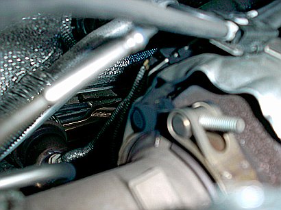

Hello!
Here's what my turbo looks like on the exhaust side after 30,000 kilometers. Should I be concerned about this, or should I just try tightening the bolt on the flange?
Once, quite amusingly during a DPF cleaning trip, I heard the turbocharger "chirping" and then I took a closer look at it.
Regards,
Pete.

Post24-08-2007, 7:31    Subject: Turbo Exhaust Flange Leak: Troubleshooting Guide Quote
Hello!
To 'perfectly' solve your problem, the best thing to do is completely remove the pipe from the turbocharger. If there's dirt like soot or rust inside, remove it with sandpaper. And now for the surprising part: apply grease to the contact surfaces; I've had good results using gray grease designed for drive shafts. Tighten everything properly and let it warm up, and it should be permanently sealed. However, it might smell a bit during the warm-up process...

pschaefer
Joined: 08/21/2002
Posts: 300
Post24-08-2007, 8:35    Subject: Turbo Exhaust Flange Leak: Troubleshooting Guide Quote
dieselmartin wrote:
I can hear my turbo quite clearly with the windows open!
And a BMR is not entirely dissimilar to a BMN...
I usually don't hear my turbo at all, except for a *slight* whistling sound when I drive up the narrow garage entrance with the window open (due to reflections off the walls). Inside the car, I don't hear anything from the turbo - although everything else on this *performance car* makes noise.
dieselmartin wrote:
I can't really judge the Russian [language/person].
Since when did it grow from "nothing" to "that"?
As I said, I could only clearly reproduce the chirping sound once, when I took a drive around near home because the DPF cleaning was activated (*clunk*). Every time I accelerated: *chirp*; it was clearly audible inside the car. Then, the next day, I checked again; I had already inspected that area before, but nothing had caught my attention then. So, the soot buildup could have been anywhere from 100 to 10,000 km in that region...icon_confused.gif
@D. Thanks for the tip!
Regards,
Pete.
Translated on 13-08-2026, 21:50.

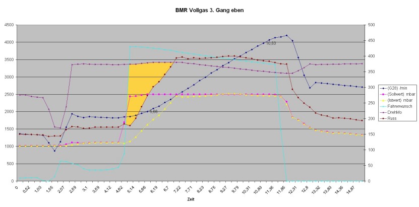

pschaefer
Joined: 08/21/2002
Posts: 300

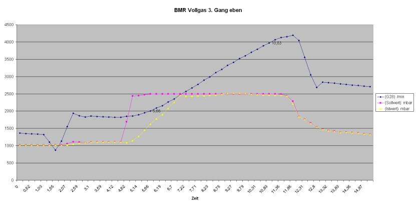

Post26-08-2007, 20:14    Subject: Turbo Exhaust Flange Leak: Troubleshooting Guide Quote
dieselmartin wrote:
Does the BMN engine have the same turbocharger as the BMR engine - the one with the insert and the multiple VTG turbine blades?
I think so. Unfortunately, I don't have a picture ready that shows a part number on the turbocharger... But as far as I know, the difference between the two engines is limited to the balance shaft module.
dieselmartin wrote:
Macht der BMN auch 2500 mbar abs. Boost pressure?
I think so. At least, I had it to that point before (see diagram in the appendix - note that "expected" and "actual" are reversed!).
dieselmartin wrote:
Do you have a front-mount intercooler (FMIC) or a side-mount intercooler (SMIC)?
FMIC
Regards,
Pete.
 File size:  60.83 KB
 Viewed:  12628 times
Translated on 13-08-2026, 21:55.

Post27-08-2007, 6:50    Subject: Turbo Exhaust Flange Leak: Troubleshooting Guide Quote
UI
He's a terrible regulator! / He does a really bad job of regulating things!
.. over the weekend, after a relaxing ride, I also went for a full-throttle ride.
The "NULL" overclocker is brilliant – it takes some getting used to, though, how slowly the LD (likely referring to a specific component or system) starts up.

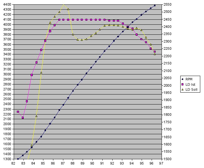

Post27-08-2007, 7:07    Subject: Turbo Exhaust Flange Leak: Troubleshooting Guide Quote
Here's the annoying consequence of the slow adjustment period:
Significant torque loss at very low RPMs!

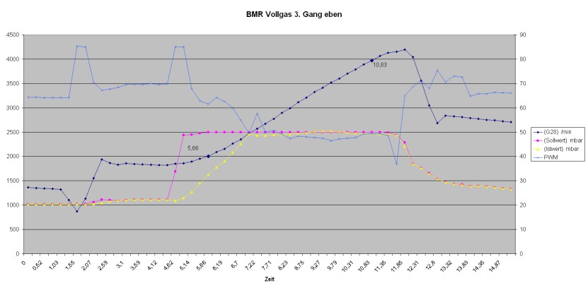

Post27-08-2007, 7:17    Subject: Turbo Exhaust Flange Leak: Troubleshooting Guide Quote
My N75 is afraid of boost pressure!
It briefly spikes to 85.1% (meaning I want full power), and then immediately goes back into "limp mode" and only increases very slowly icon_sad.gif.

Post27-08-2007, 7:44    Subject: Turbo Exhaust Flange Leak: Troubleshooting Guide Quote
Okay, that's some really bad behavior from my device. By the time of the log I mentioned above, I already had the 0424 software version installed, which is noticeably slower than my old 0061 software version.
I'm going to try running a logging session tonight using the VAG-COM in "Turbo" mode (which is always a bit annoying with DSG transmissions). My previous log was taken in 4th gear (in S-mode, accelerating until the DSG shifted up).
It gets interesting for me when I eventually get the 1185 software installed; let's see how it looks then.
Regards,
Pete.
Translated on 13-08-2026, 21:59.

Post27-08-2007, 8:06    Subject: Turbo Exhaust Flange Leak: Troubleshooting Guide Quote
pschaefer wrote:
I'm only seeing a pressure setting of 2450 mbar, but it should increase to 2500 mbar once I switch to gas.
Why does the BMR now need those extra 50 millibars?
It's strange that all of this is happening icon_wink.gif.
Translated on 13-08-2026, 22:01.

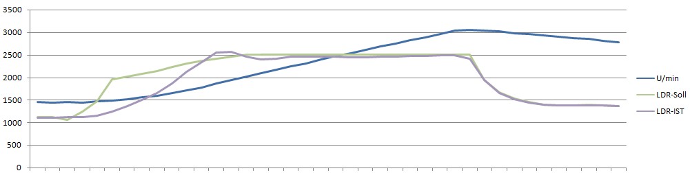

Post04-09-2007, 20:27    Subject: Turbo Exhaust Flange Leak: Troubleshooting Guide Quote
Here's something to add: BMN with data as of version 1185 (regarding the target value of 2450 for LDR).
 LDR-BMN-1185
 File size:  51.37 KB
 Viewed:  9738 times
Translated on 13-08-2026, 22:03.
Joined: 03/13/2003
Posts: 10121
Location: in der Werkstatt
Post04-09-2007, 20:39    Subject: Turbo Exhaust Flange Leak: Troubleshooting Guide Quote
Is that a DSG?
Because the boost pressure never really drops.
Kannst du versuchen, ein Log wie meines im 3. Are you going somewhere?
What exactly are you trying to tell me? Is my BMR particularly slow with the boost pressure?
Translated on 13-08-2026, 22:04.

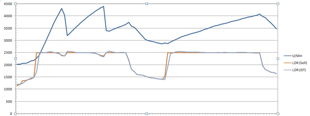

vagtuning
Guest
Post04-09-2007, 20:48    Subject: Turbo Exhaust Flange Leak: Troubleshooting Guide Quote
Hmm, I can't really tell you.
I know of two cases within my circle of acquaintances – I didn't report it back then.
Here's one from the BMN-1185 manual switch...
No, it was about the fact that the 1185 also regulates properly to the target value of 2500 on the BMN (battery management system).
Okay, here's the translation:
'I'm also attaching the complete HS Log.'
 BMN-HS
 File size:  34.6 KB
 Viewed:  9649 times
LOG-BMN-version-1185-SB-HS.CSV
 komplettes
komplettes
 File name:  LOG-BMN-version-1185-SB-HS.CSV
 File size:  71.11 KB
 Downloaded:  980 times
Translated on 13-08-2026, 22:05.
