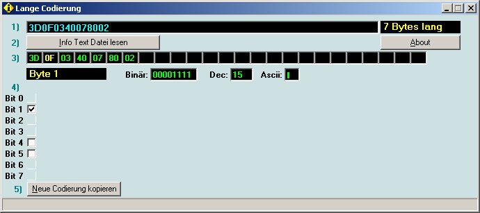

Hi.
Another strange phenomenon on my new laptop with Windows XP.
In LCode, some checkboxes only appear when you hover the mouse over them.
Is this a known issue, and if so, is there a solution?
Thank you.

Post14-01-2008, 12:56    Subject: LCode doesn't display all checkboxes Quote
This will only happen if you use the Tab key to navigate through the fields in section 3.
Were all the boxes drawn initially, or do I have to click on the fields with the mouse? If I click on the fields, the bug no longer occurs.

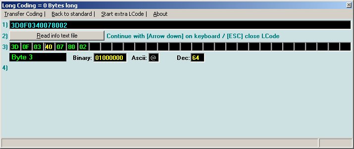

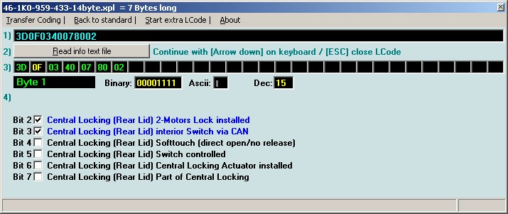

Post14-01-2008, 15:33    Subject: LCode doesn't display all checkboxes Quote
I don't know if that's supposed to be the case.
"However, the new LCode doesn't display anything when it loads its own example (see LCode_Bug2)."
If you load a different XPL yourself, you'll see something. It apparently doesn't discard unused bits (see LCode_Bug3).

Post16-01-2008, 11:38    Subject: LCode doesn't display all checkboxes Quote
The following has emerged:
>> The problem with LCode 604 is known, but it only occurs in rare
>> Cases where we haven't updated the old VC 704 in that regard.
Instead of pressing 'Tab', just click in the fields and everything will be fine.
