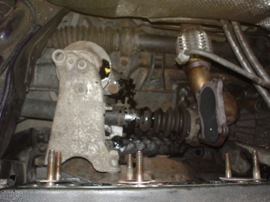

Yesterday, while driving on the highway at 150 km/h, I experienced a turbocharger failure in my Galaxy.
'Now, I can't get a turbo for my Galant because, supposedly, the one from the Golf is rotated 180 degrees, which means the exhaust side is on the other side...'
Is that correct?!?
My turbocharger has the part number N. 028 145 701 QX.
Golf is the same.
Engine: 1Z, manufactured in October 1996, TDI, 90 horsepower.
Installation: When viewed from the front of the vehicle, the intake side is on the right and the exhaust side is on the left, located on the rear side of the engine.
This photo was taken from a low angle, looking upwards.
http://www.mhernach.com/tdi/PREVIEW/02100002.JPG
More photos can be found under http://www.mhernach.com/tdi/PREVIEW/INDEX1.HTM.

Hmm... same part number means the same part.
The aforementioned turbocharger was installed in the following models: Golf, Caddy, Sharan, Vento, and others.

Post19-10-2006, 21:59    Subject: Turbo Question: Get Fast Answers Now! Quote
Hi.
The photos are all so detailed and taken from such a close range that I can't tell where the wastegate is located.
Here's the installation space for the 1Z turbo from my Golf 3 Variant, manufactured in December 1995 (so, model year 1996), photographed from above - the wastegate is located _in front of_ the exhaust outlet.

Okay, so now my actual question...
Sharan 028 145 701 QX
Golf 028 145 702 FX
Does the Golf's engine fit into the Sharan, or not?

I wanted to have the two loaders, 28 145 701 QX and 702 FX, delivered today and take some pictures for you to see if there are any differences.
I chose the manufacturer BU for this. One charger is called 124156 and the other is 124367. The 124367 is no longer available and has now been replaced by the 124156. So, it's the same charger. It's not very precise, but hopefully this information will be helpful to you.

Having now acquired a reasonably priced turbocharger, including the exhaust manifold, and having already installed it, I can definitively say that the turbocharger from the Golf 1Z is identical to the one from the Seat Ibiza 1Z.
My car is running smoothly again... *lol*
