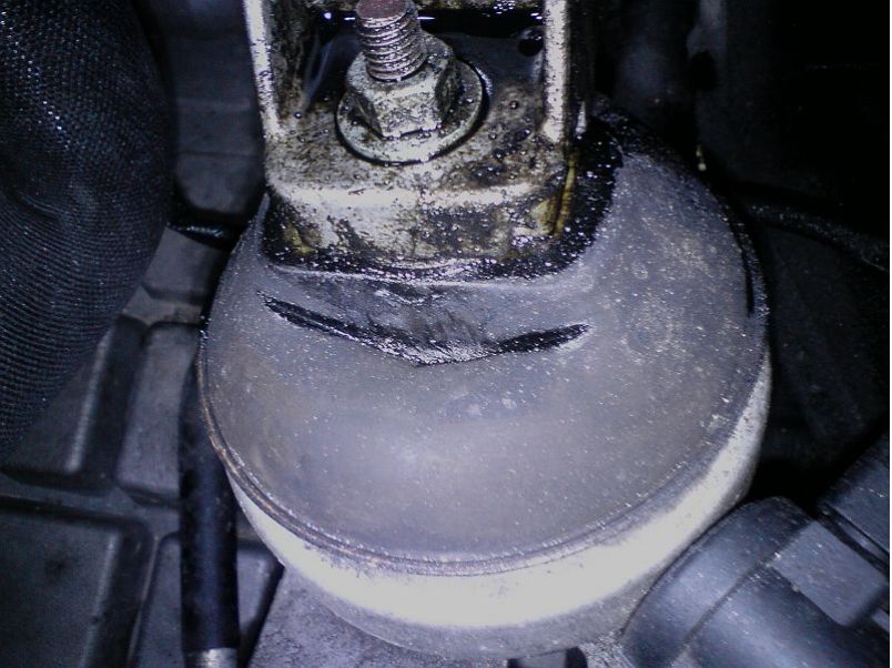

Yesterday, while replacing the AGR (air intake control valve) and some seals, I noticed that my left engine mount has a dent in it. Besides the dent visible in the photos, the bearing is bulging outwards.
Is this normal, or is something broken? I'm experiencing a slight jerking sensation when starting up, below 1500 RPM. However, there are no error codes stored, and the clutch and dual-mass flywheel have already been replaced.
