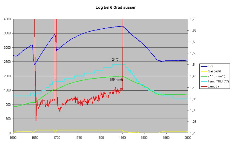

Post15-10-2009, 21:05    Subject: FMIC: Max. Temp. Difference (3C) Quote
Okay, please provide the text you would like me to translate from German to English.
I came by to log something today.
It was 6 degrees Celsius outside.
Engine at 61 degrees, then drove onto the highway.
Measurement started at approximately 90 degrees of engine rotation and continued up to 98 degrees.
Unfortunately, I couldn't continue any longer, because of the people from Saarland icon_smile.gif.
 File size:  45.87 KB
 Viewed:  12622 times
