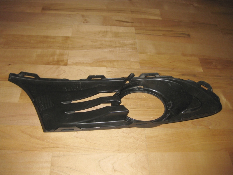

Post30-11-2010, 13:14    Subject: Fogger Replacement G6+ Quote
Here's the killer grille, which I finally managed to get out after about 20 minutes of fiddling.
Some of the violence and, especially, figuring out where the clips were located was very time-consuming.
