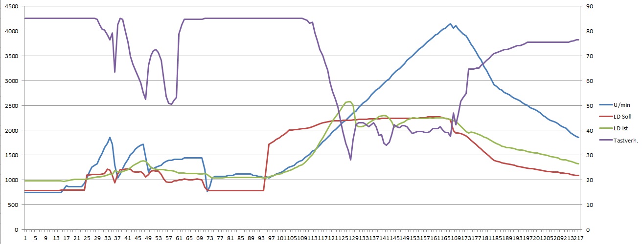

I have just created a log, but unfortunately, it doesn't include the target values. However, in my opinion, it's already clear that the LD (likely referring to a specific parameter or process) is oscillating excessively.
What I've also noticed is that the injection start timing is at -3.0° at idle, isn't that too early? (See attachment.)
Edit 1: Regarding the start of the injection process, I misinterpreted the value before, but it is now correct.
'Edit 2: I've now added the correct logs (including setpoints, etc.) and posted a new diagram of the log data. It seems I need to work on the VTG (Variable Transverse Geometry) system...'

 Diagramm zu LOG-01-011-LD.CSV

 Diese File kann ich mit dem Scope irgendwie nicht richtig darstellen, deshalb hab ich die Werte im geposteten Diagramm mit Excel grafisch aufbereitet..

Post03-06-2011, 10:49    Subject: 2.5 TDI BFC Camshaft Photos - Comments Welcome Quote
christians wrote:
I don't find the swingers to be dramatic.
"Beautiful" is one thing, but this is something else. It would be interesting to see if only MWB 11 and MWB 8 are logged simultaneously, whether the soot limit is reached during a pressure drop (which could indicate a "Bonanza effect" during adjustment, meaning the power output is not consistent).

Post03-06-2011, 11:23    Subject: 2.5 TDI BFC Camshaft Photos - Comments Welcome Quote
Attached is the requested log for MWB 8 and 11, combined.
I've adjusted the VTG (Variable Turbine Geometry) setting by half a rotation 'earlier' (using an Allen key), which has changed its characteristics. However, the driving behavior is still the same: it's quick up to 2700 RPM, and then there's even more power.
I'm going to reset the exposure to the original setting, as you can see, this will result in significant underexposure.
