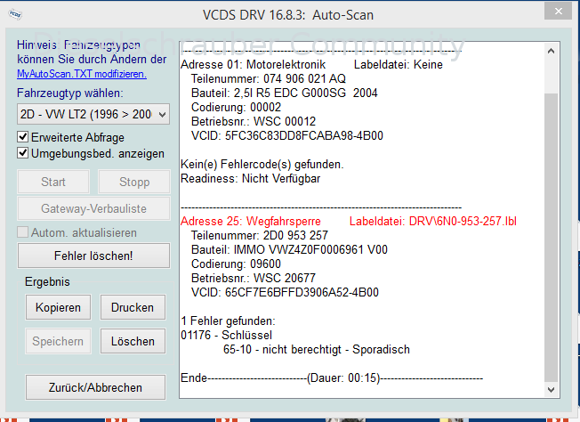

Here's my car scan, and thanks for your help so far...

chli1976 Profi-Schrauber
Joined: 11/29/2003 Posts: 873 Karma: +186 / -0
11-12-2016, 18:35 Subject: WFS Login Code Missing: What to Do? |
Quote |
The VW tester connects to this database via the intranet and retrieves the necessary data.
There are two ways to access the login system. Either through the engine control unit (ECU). This would require a BDM tool or something similar.
Or, translate the instrument cluster.
It would also be interesting to know the year of manufacture. As far as I believe, it's relatively inexpensive (interface + software) up to around 2007.
VCDS
